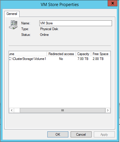

Fri Apr 02, 2021 3:02 pm
Here are screenshots of the volumes
VM Store Label.PNG (11.37 KiB) Viewed 8575 times
Cluster Storage Volume Name.PNG (5.05 KiB) Viewed 8575 times
