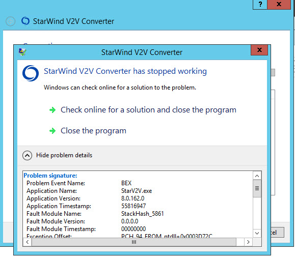

Hello, I have a couple of large 2TB VHDX files that I need to convert to use with VMWare vSphere 5.5. If I try to convert using Starwind V2V I come across one of two issues.
1.) if I try VMWare Growable Image it says file is too large
2.) if I try VMWare Pre-Allocated Image I get the error in the attached screen shot. Details:
Problem signature:
Problem Event Name: BEX
Application Name: StarV2V.exe
Application Version: 8.0.162.0
Application Timestamp: 55816947
Fault Module Name: StackHash_5861
Fault Module Version: 0.0.0.0
Fault Module Timestamp: 00000000
Exception Offset: PCH_94_FROM_ntdll+0x0003D72C
Exception Code: c0000005
Exception Data: 00000008
OS Version: 6.3.9600.2.0.0.8464.21
Locale ID: 3081
Additional Information 1: 5861
Additional Information 2: 5861822e1919d7c014bbb064c64908b2
Additional Information 3: d1d9
Additional Information 4: d1d94a13d3609d6b740644c12508f581
Read our privacy statement online:
http://go.microsoft.com/fwlink/?linkid=280262
If the online privacy statement is not available, please read our privacy statement offline:
C:\Windows\system32\en-US\erofflps.txt
Thoughts ?

alexander (staff)
Joined: Tue Aug 07, 2012 11:06 am
Thu Jul 09, 2015 2:17 pm
VMWare doesn't support virtual discs larger than 2040Gb independent of their type ( growable or pre-allocated ).
You not able to create 2Tb (2048Gb) or larger VMWare images.
In this case you got correct message when try convert to Growable VMWare image.
Thank you for report,
we fix bug with pre-allocated image size checking asap.
Alex
