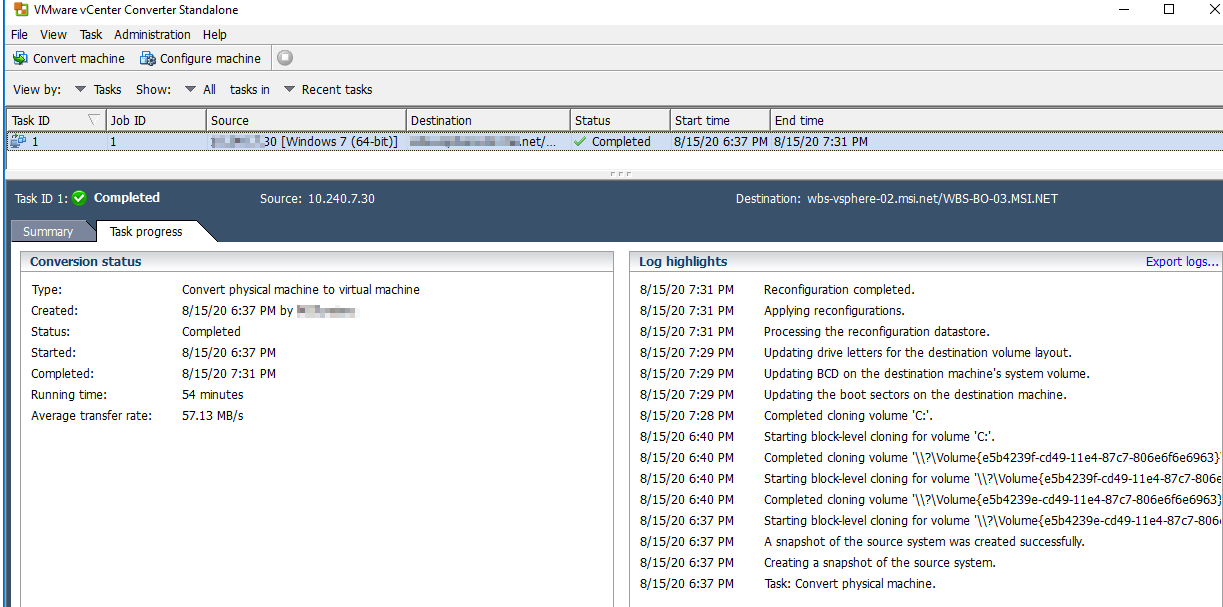

2) I then used VMware vCenter Converter Standalone Client, version=6.2.0, build=8466193 against the same target PC and it took about an hour to convert to ESX and then.. booted cleanly.
2020-08-15 20_08_44-Photos.png (51 KiB) Viewed 20251 times
So I wonder why the VM product works but SW doesn't?
Happy to provide more logs, info etc if that might help.
