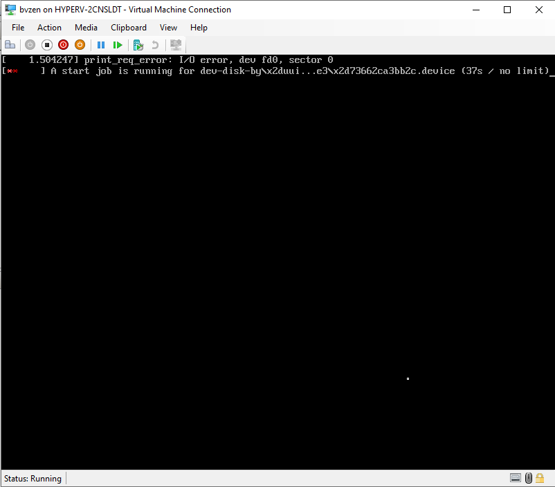

Okay I understand now. I did try and edit fstab already with the new UUID, and it did not boot (I do see grub everytime). However, I did not try the previous steps of commenting out /dev/sdb1, to see if /dev/sda1 boots. Last night I converted just /dev/sda1, I am about to connect it to a Clean new VM and see if it boots (with /dev/sdb1 commented out in fstab. If it boot I will attach /dev/sdb1 and see if it still boots.
I did, however try some simular methods, what I tried previously:
- Converted the whole machine (Failed to boot)
- Built a new clean VM and attached the disks to the new clean VM (did not boot, same result see grub menu but no disks boot)
- Tried using different cloning methods for the disks, and then attached them to a new VM (Same boot result, I see grub menu but no disks boot)
- Tried edting fstab, to have the disk boot from the new UUID (Same result, see grub menu but disks will not boot)
- Tried editing /etc/fstab to boot from LABEL ROOT (Same result, /dev/sda1 will not boot, only see grub menu)
- Used the SuperGrub rescue disk, to see if I could detect grub.cfg (I can) and then edited the entried to try and boot from the new UUID (Same situation, /dev/sda1 does not boot)
- Used the Super Grub disk to detect grub.cfg and edited the entries to boot from root=LABEL=ROOT (Same result, the I it tries, but cannot boot from /dev/sda1
It should be noted that the original ESXi VM I am trying to convert is healthy, and happily boots, in fact it is running again right now. So this is all perplexing to me. I am still trying what you suggested as well.

Okay I tried what you said:
- Converted the disks one at a time (No Machine attached)
- Created a NEW Fresh VM
- Attached /dev/sda1
- I made sure NOT to boot yet
- I then Booted from a LIVE SLES 12.5 iso in RESCUE mode
- I mounted /dev/sda1 from the Live Environment IE:
cd/
cd mnt
mkdir sda1
mount /dev/sda1 /mnt/sda1
chroot /mnt/sda1
I then edited /etc/fstab IE;
vi /etc/fstab
- I then commented OUT the entry line in fstab for /dev/sdb1
- I then boot the new VM for thje first time and......
Same result, I see grub, but /dev/sda1 cannot boot :(
I See Attached Screenshot.
