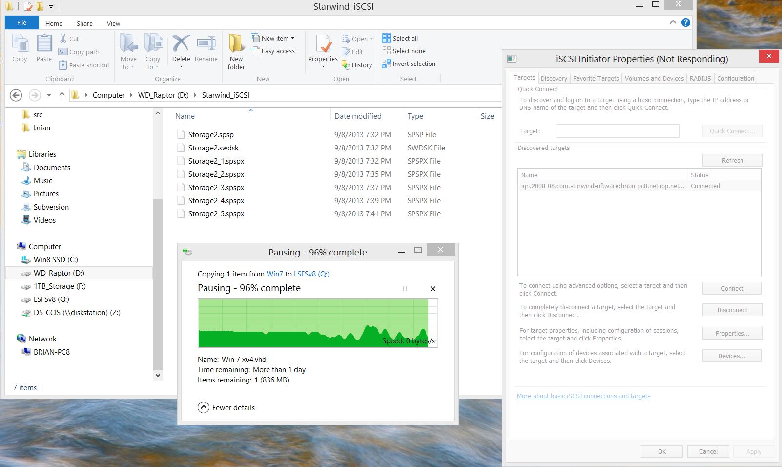

On my workstation, Win8/64 I have used SW Free version 6 for many months. (I also have a paid SW Native SAN v6 in production).\
I have a physical Drive d:\Starwind_ISCSI with a 65GB image file, exported as Q: with 3 hyper-v vms. This has been working flawlessly for months.
I Upgraded to v8 beta on my workstation. On another physical drive f:\Starwind I create a 40GB LSFS container. Mounted it as R:
First thing i go to do is copy one VM 30GB from Q: to R: All looks good for first few mins, copying at around 90MB/sec. ABout half way through file copy, speeds fluctuate. OK could be caused by many things.. Near 90% of the file copy, speed goes to 0 bytes/sec. I left it for 10 mins, no change.
Event log filling with "Target did not respond in time for a SCSI request. The CDB is given in the dump data."
Ended up having to reboot..
On next boot I delete the new 40GB LSFS container and target.
I copy the 3 Hyper-V VMs from iSCSI Q: to physical f:\
Now make a new LSFS container 40GB. Mounted as R: again.
Copy from F: one of the VMs 30GB to new R:
Again, failed at just over 90%.
EventLog:
A connection to the target was lost, but Initiator successfully reconnected to the target. Dump data contains the target name.
Should I post logfiles, or just wait for next beta?

Had to reboot again after that. On next reboot, Starwind service did not auto start, so I start it manually.
Now connect with SW console, and I see a warning that it is trying to mount the LSFS device, but just stays like that forever ..

After a few more mins, SW service crashed.

Please provide me with additional information:
- What are the parameters of the LSFS device ? Did you use default parameters for LSFS device (i.e. "LSFS block size", "Deletion support" etc. ) ?
- What cache did you use and what was its size?
- Is the service running on the same machine as device is mounted or the device is mounted from another machine through network?
- What are sizes of .spspx files (it is not visible from snapshot)?
- How much free space is there on your disk D: ?
Thank you
CCI
Posts: 10
Joined: Wed Dec 19, 2012 5:28 am
Mon Sep 09, 2013 5:10 pm
I used all defaults for LSFS
Defaults for cache as well (It used 128MB write-back)
All on the same machine.
.spspx files were 4GB I believe.
D: had about 90 GB Free
