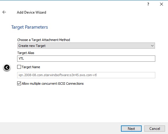

Ok, I have been looking the documentation since days now and I found that on the GUI management there is an option called "Allow multiple concurrent iSCSI connections". I haven't found a way to set this through PowerShell in the free edition.
Can this be my problem? Is it possible that the VTL uses a single connection by default at for example 23Mbps in our environment? And if I would have multiple parallel connection it could increase the speed over 100Mbps?

Now, I’d like to answer your second post. The option “Allow multiple concurrent iSCSI Connections” is in VTL not for performance concerns. This option allows for multiple initiators (i.e., servers) to talk to a single target (i.e., tape). And, this option is enabled by default.
