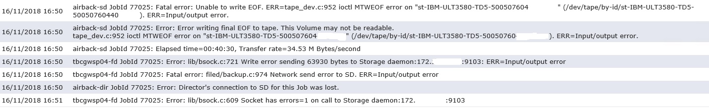

I'm trying to work with WBSAirback (Bacula Enterprise) and TS3500 LTO5 drive through Starwind Tape redirector.
I'm able to mount, label and write some backup jobs, but sometimes I get an I/O error (results attached)
These are the errors logs on Starwind console..

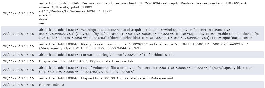

I have just finished a successfull backup and when I try to restore I have these errors (image attached).
WBS-error-restore
WBS-error-restore
