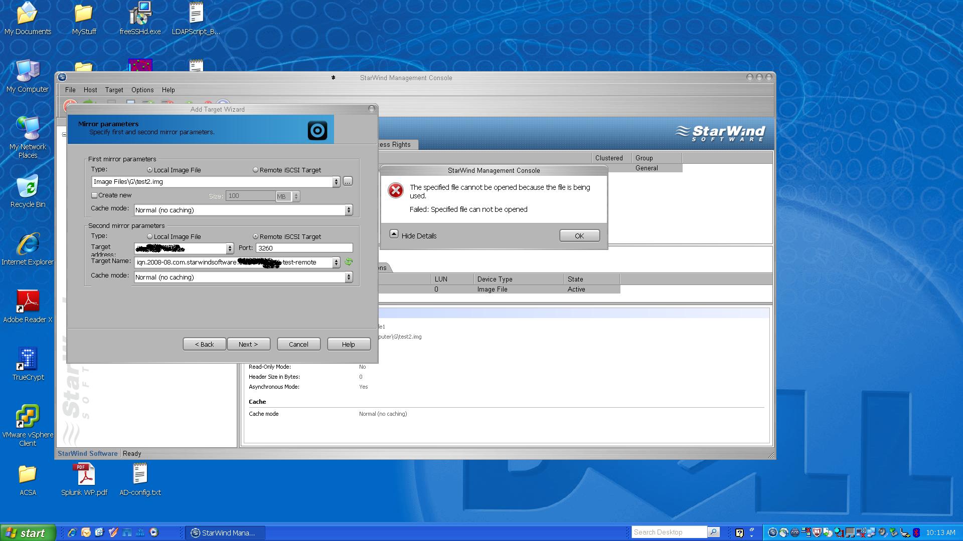

I have been trying to setup a mirrior using a currently running image file on the main storage and a newly created image file on the remote. Everytime I select as the first mirrion a current iamge file it errors. States the file is in use. Is this not possible?

I configured an image file on primary storage
setup remote image on backup storage
start to configure mirrior
when it asks for first mirrior target I select the primary storage image file
the second target is the remote image file
I select next and errors stating file in use
If I select to create a new image file on primary storage it works.
It will not work when I select the iamge file on primary storage at all.

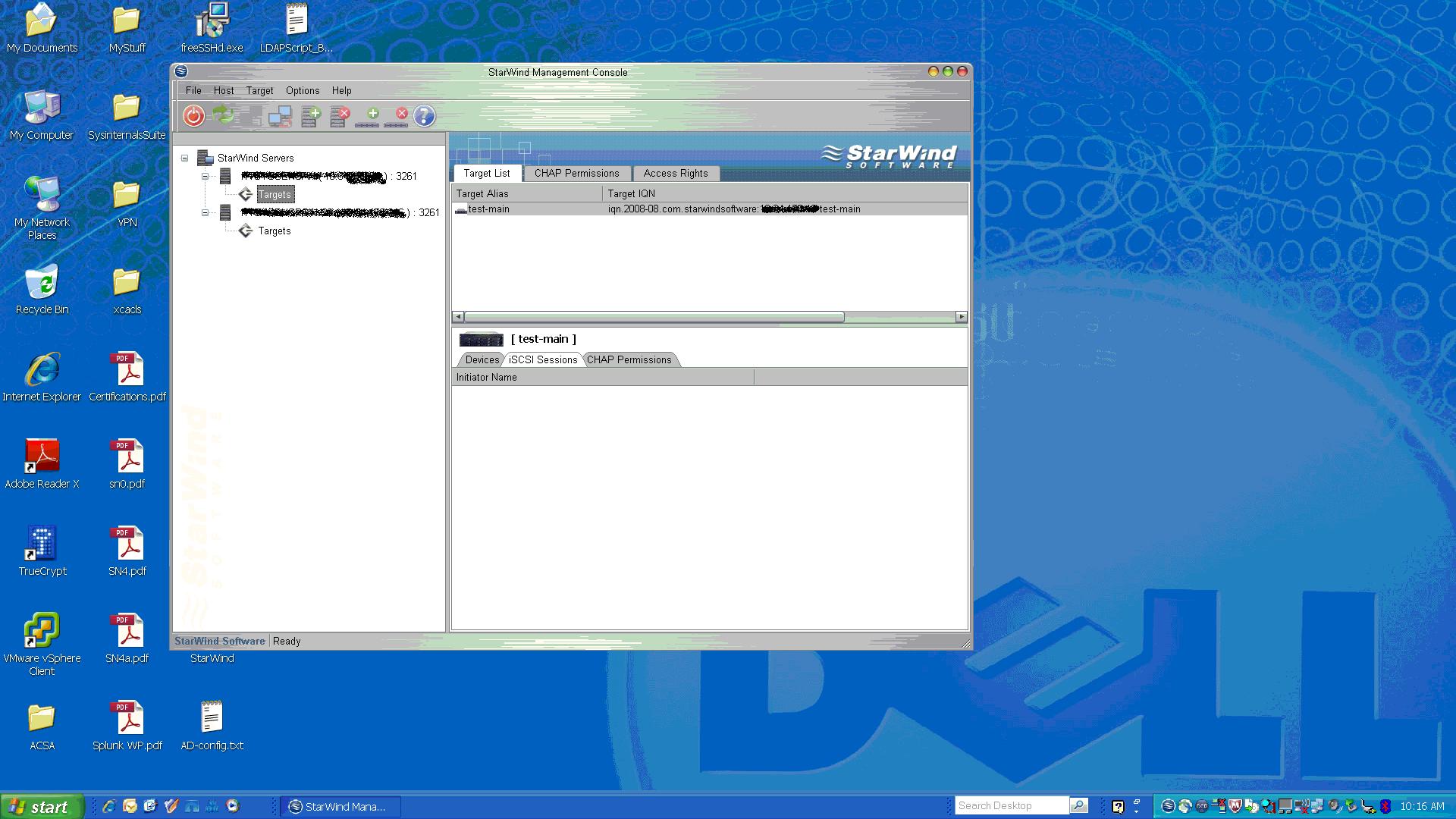

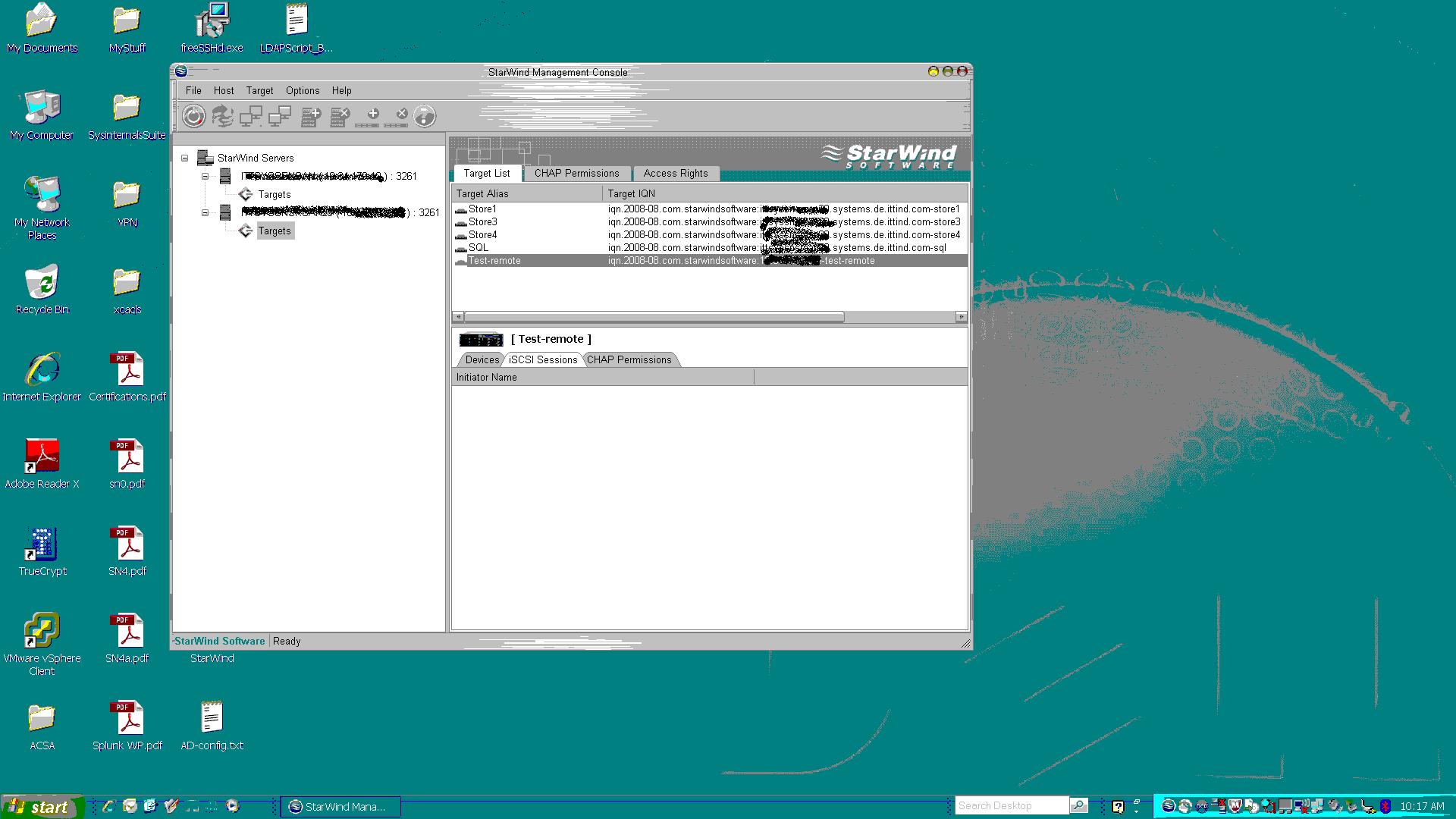

Sun Oct 23, 2011 7:21 pm
So the remote Image File target has no any other connections, correct?
Could you please provide us with screenshots of the error and the SW management console with remote iscsi target selected and opened the iSCSI Session tab?

Mon Oct 24, 2011 4:47 pm
Here are the 3 screenshots. One of the error and each host iscsi targets

Mon Nov 21, 2011 10:15 pm
OK I got this fixed. Both systems have to be running the same version. Once I updated our current target I was able to connect a mirrior. Thanks for your assistance.
