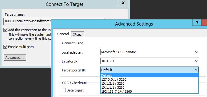

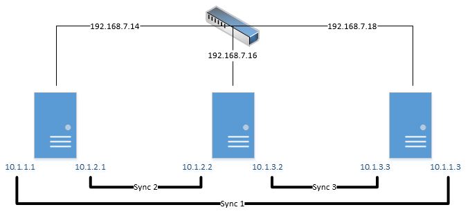

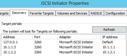

I'm having problems connecting the iSCSI targets on a new v8 installation and wondering if what I have designed should work. In v6, there were 3 sync channels on the configuration manual diagrams but in v8 there seems to be only 2 sync channels. We have three servers, each with two 10Gig ports that I've connected directly to each other to bypass the need for a 10gig switch. The 192.168.7.x network is only for heartbeat. I've created the CSVs fine with replication and the iSCSI discovery is working but when I am trying to connect the target in MPIO I am unable to choose the target portal IP that is connected to the initiator IP. From following the beta manual, on server 1 I should be able to choose 10.1.2.2 as a target portal IP when I choose 10.1.2.1 as the initiator IP but I do not get that option.

Ahhh, yes we are running converged where they both are on the same piece of hardware. Now that I look at the network design, we don't really have any MPIO as there is technically only one way that Server 1 can connect to Server 3. Is that still a viable configuration or would I need to configure some kind of network routing to allow a connection from Server 1 to Server 3 through Server 2?
