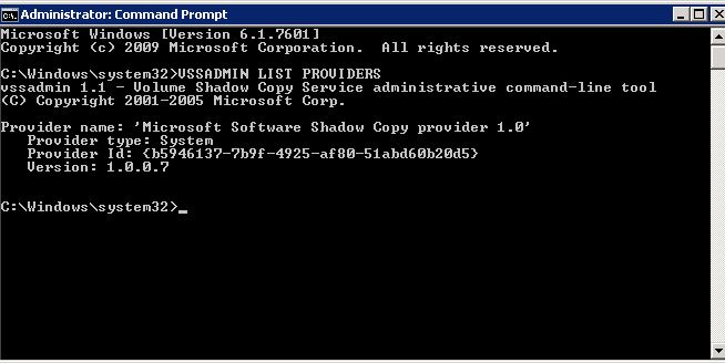

Digging a little more lokks like it's not working :cry:
When i issue VSSADMIN LIST PROVIDERS, Starwind is not listed (see below)
Any ideas on how to get this working?
Jeff
C:\Windows\system32>vssadmin list providers
vssadmin 1.1 - Volume Shadow Copy Service administrative command-line tool
(C) Copyright 2001-2005 Microsoft Corp.
Provider name: 'Microsoft Software Shadow Copy provider 1.0'
Provider type: System
Provider Id: {b5946137-7b9f-4925-af80-51abd60b20d5}
Version: 1.0.0.7

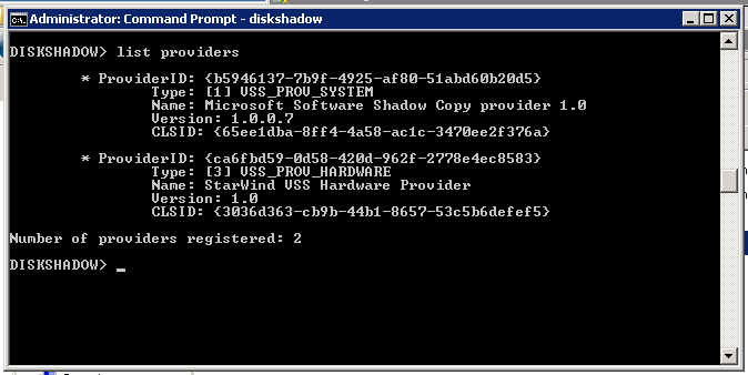

If the Hardware VSS Provider was installed correctly, what output should I expect to see when I run VSSADMIN LIST PROVIDERS ?
Jeff
Yuriy (staff)
Posts: 56
Tue Oct 21, 2014 9:06 am
You should see something like this.

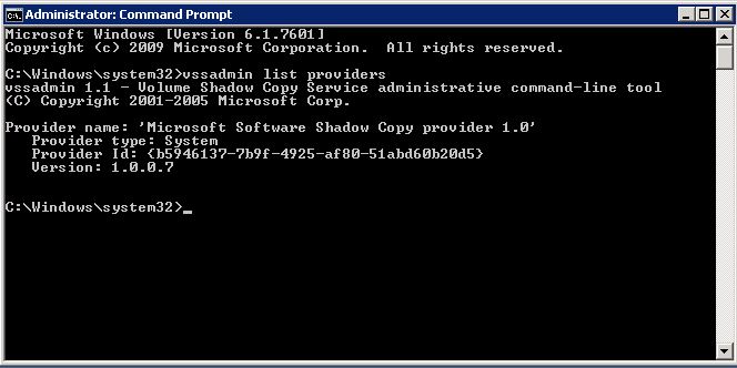

Tue Oct 21, 2014 10:56 am
I am not seeing that; only the Microsoft Provider is listed (see below). I've tried restarting the service, rebooting, and re installing, but nothing seems to help. Ideas?
Jeff
Thu Oct 23, 2014 9:17 pm
Just a quick update: we have reproduced the issue in your lab and started to work on the fix.

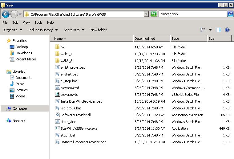

Sat Nov 01, 2014 2:32 pm
Yuri,
I downloaded the file but it did not seem to fix the issue; I still have only the Micrsoft Software Provider listed. Were their supposed to be more files in the ZIP file you attached? There were only two files in the zip file, UnInstallStarWindProvider.bat and InstallStarWindProvider.bat. I coped both of those to C:\Program Files\StarWind Software\StarWind\VSS, and then ran them in order as an Administrator, but still no love :cry:
Jeff
Yuriy (staff)
Posts: 56
Mon Nov 03, 2014 8:57 am
jhamm@logos-data.com wrote:Yuri,
Jeff
You should replace files in this forlder:
C:\Program Files\StarWind Software\StarWind\VSS\hw
Would you, please, provide screenshot with results of script work?
We will publish an update soon. You will be able to test it.
