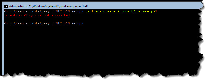

Exception Plugin is not supported

I've been trying to write some scripts to get this all working in a 1, 2, 3 then 4 scenario.
I wrote and tested a bunch of scripts and they all worked.
Now, I'm getting an error when I try to create a 2 node HA volume... with scripts I have tested before without issue...

What am I missing?

Is StarWindX installed on the system where you try to run this?

Wed Jan 17, 2018 6:50 pm
Boris-
Yes, it is/was.
I did figure out that the license file didn't get applied correctly in my script.
I used the command line:
..\..\starwind-v8_build_11456.exe /SILENT /COMPONENTS="service,service\starflb,service\starportdriver,StarWindxDll,StarWindXDll\powerShellEx" /LICENSEKEY="..\..\StarWind_Virtual_SAN_Free_License_Key.swk"
An uninstall and re-install with this:
..\..\starwind-v8_build_11456.exe /SILENT /COMPONENTS="service,service\starflb,service\starportdriver,StarWindxDll,StarWindXDll\powerShellEx" /LICENSEKEY="..\..\StarWind_Virtual_SAN_v8_no3_Free_License_Key\StarWind_Virtual_SAN_Free_License_Key.swk"
And it worked.
Not sure how I dropped part of the path from the script... but fixing the install script fixed the issue.
And, from what you mentioned...
It seems that this error is related to proper installation of the StarWindX modules on the system... and licensing thereof.
Correct?
Thanks.
Hope this helps.
- Jeff Morlen
Follow me on Twitter (@tig_jeff)
Wed Jan 17, 2018 9:30 pm
That's great you managed to figure out the issue with the license not applied properly.
Generally, that error might have been caused rather by incorrect operation of StarWindX instead of StarWindX being not installed on the system where you run the installation script. The worst thing you would need to do in that case is reinstalling StarWindX using the two components "StarWindxDll,StarWindXDll\powerShellEx".
