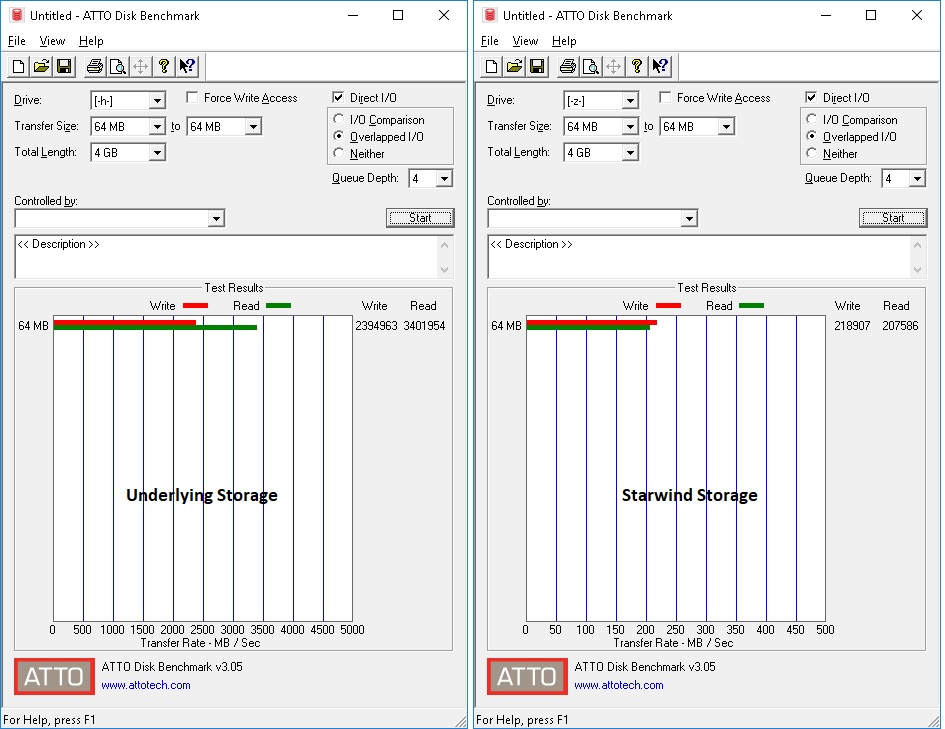

I have some Starwind Virtual SAN performance Issues and would love some pointers.
I have a 2 node setup with the following-:
2 X Dell R630 each with:-
2 x 1GB Nics (Management)
4 x 10GB Intel X-540 (All setup with Jumbo and performance checked with iperf3) getting approx 9gb transfer!
ALL SAS SSD BASED:-
Boot 2 x sas Mirrored.
Data 6 x 1.6TB SAS SSD (Raid 5) 7.2TB Total
64 GB Ram
Dual Intel E5-2620 V3
The underlying data performance is good with a sustained sequential write of 2500 mbs and read of 3500 mbs (ATTO Disk Bench)
If I create a disk (Not HA just yet) and connected using 127.0.0.1 loopback and bring online and perform some tests the performance is horrible, please not I've not setup High Availability yet.
If tried various settings with Thick & Thin provisioned with various cache settings and the performance is virtually always the same.
Am i doing something wrong here or am I testing this incorrectly? Please note I've not even replicated yet so no NIC interfaces are actually benig tested, I'm quite familiar with Starwind and am looking for some suggestions.
Kind regards
David
ATTO Benchmark
ATTO Benchmark
Starwind Test.jpg (165.43 KiB) Viewed 24162 times

I'm not even talking about replication yet, I'm talking about local starwind storage using iSCSI loopback on 127.0.0.1, this should not even use any network resource, it's not replicated yet.
I just don't get the performance loss.

Hello Vitaliy,
I've attached all the logs as requested, every prefixed with US = Underlying Storage and SW = Starwind Storage
The SW Config was a 100GB Thick Provisioned attached locally using 2 MPIO 127.0.0.1 connections formatted to NTFS ans attached as Drive Z:
Does this help?
Tests.zip
(17.84 KiB) Downloaded 1623 times

Hello Vitaliy,
RAID5 on SSD: Yes they match 100%
I created a HA and re-setup the iSCSI to the following:-
2 Loopback connections only (no MPIO link to replicated device) (Policy Least Queue Depth)
The results were the virtually the same.
I then added the 3rd connection to the remote HA via MPIO and I've attached the results, this performance was increased but this was because I could see the iSCSI traffic going to the remote device at circa 6 GBps, shouldn't the iSCSI be using the loopback and if so why is it's performance so bad?
