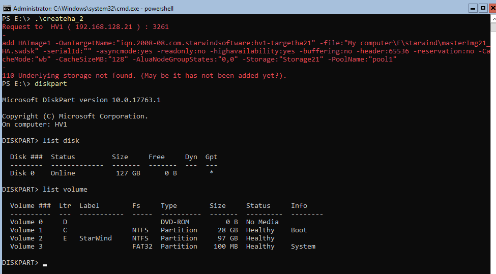

The first error i received, was "200 Failed: internal error..." and now i understood it was because i changed the $path from "My Computer\E\starwind" to "HV1\E\starwind" :(
With your code, it progress but I get a new error (please see attached).

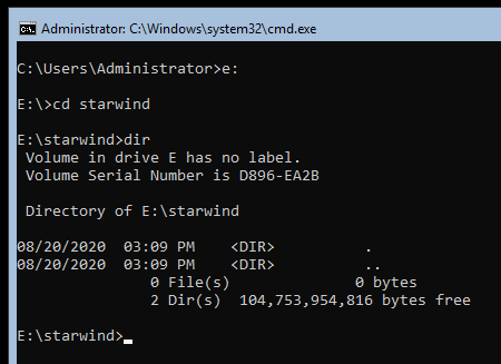

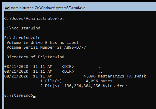

The file is created in the first node (E:\starwind\masterImg21_HA.swdsk) but not in the second.

Did you already initialize the E:\ drive in the system? I mean is My computer E:\ already a path?
arorris
Posts: 10
Joined: Thu Aug 20, 2020 6:19 am
Fri Aug 21, 2020 9:26 am
yaroslav (staff) wrote:Did you already initialize the E:\ drive in the system? I mean is My computer E:\ already a path?
Yes of course, on both hosts! Otherwise how the *.swdsk file would be created in the first host?
Attached are the files with the path - please do check there is a file created on first host, but not on the second.
Posts: 3602
Fri Aug 21, 2020 9:55 pm
Hey, sorry for the delayed response...
Will be happy to see the diskpart outputs too.
Please try clearing the directories and run creation from scratch.

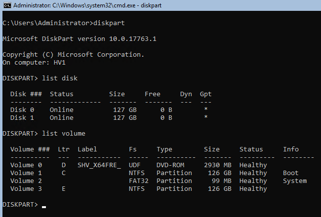

Disk 0 is the boot drive with Starwind, Disk 1 has only one partition, the E drive. NTFS formatted.

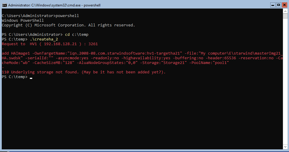

UPDATE
I made a clean installation of both Hyper-V Server 2019. I prepared the hosts as previous, that means:
Installed Hyper-V Server
Installed all updates
Changed IP's and hostnames as previous (HV1 / 192.168.128.21 / 10.10.10.11 / 11.11.11.11) - (HV2 / 192.168.128.22 / 10.10.10.12 / 11.11.11.12)
Enabled Jumbo frames on all 3 adapters and ping each side successfully, with 3 different switches, one for every connection
Disabled firewall and enabled all roles / features
This time I have one disk, with 2 partitions - check screenshot. Second partition is GPT / NTFS
Installed Starwind with all options checked
I run the script you gave me, and still receive the same error :cry: :cry: :cry: :cry: :cry:
File is created in E:\starwind folder.
I am getting crazy....
Full code is here
