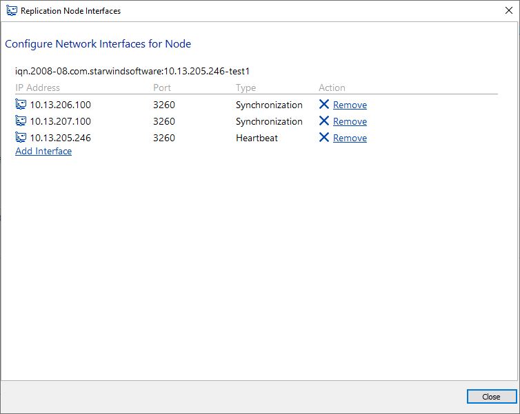

After changing to MTU 9000 in switch it has worked but later finding issue in synchronization.
I have uploaded the logs kindly check and help me out.
VM2_Sync Command.JPG (17.42 KiB) Viewed 17677 times
