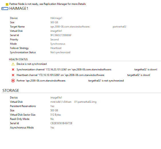

In my case when I boot the remaining partner up, starwind shows the lun is in maintenance mode (which of course it is).
When I try to use MaintenanceMode.ps1, but change the operands to (false, true) to try to take it out of maintenance mode, it fails because "connection with partner node is invalid."
#code: params: enable, force -> $false, $true
When I try RemoveHAPartner, it gives "Error: 200 Failed: operation cannot be completed."
Is there some "Standard Operating Procedure" for if one of the nodes is failed and unrecoverable, and the second node is in maintenance mode, to bring the operational node back out of maintenance mode into "limited availability" mode, or to bring it back up in "image" mode?

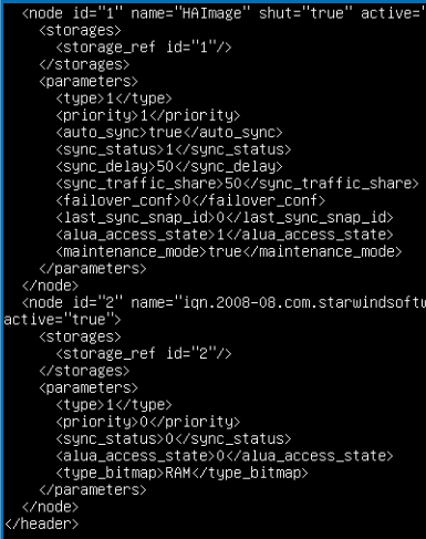

You need both partners to exit the maintenance mode.
You can edit the headers
1. Stop StarWindService on one node
2. Go to C:\Program Files\StarWind Software\StarWind\headers and copy the corresponding *_HA.swdsk
3. Edit that file.
4. aim for <maintenance_mode/> area and set it to false for both local and partner.
5. Start StarWindService and see if the target is synchronized and available over iSCSI (You might still need to mark it as synchronized).
It won't work until the device is in maintenance mode.
If I understand you correctly, you are saying that using just the script, taking a HA pair out of maintenance mode requires both to be intact.
And, If both are not available, it is possible to edit the headers on the one that is intact, by first stopping the Starwindservice on the remaining node,
editing the applicable *HA.swdsk, look for <maintenance_mode/> and set it to false for both nodes.
Are you saying? - This would then when I restart the service see "both" as out of maintenance mode, but then quickly realize that the missing one is not available.... and fall back to limited availability?
How do I "mark" the one remaining copy "as synchronized" as you referred to above in ()

So your saying RemoveHAPartner doesn't work unless the device is in Maintenance mode.
The LUN is showing in the web interface as "Down" and in "Maintenance" mode already.
I was trying to get it out of maintenance mode, so that it would go back to "limited availability" when it can't find the partner.....
My thought was then in that state, to remove the forever lost partner and then add a new HA partner.
Clearly there are some steps I have misunderstood.

I found this file in /opt/starwind/starwind-virtual-san/drive_c/starwind/headers/partnerha02
I tried editing this using sudo nano with the services it would let me stop stopped.... the <maintenance mode /> was in the node id="1" section, which seemed to refer to the primary node. I set it to false, and after saving rebooted the node from the web interface.... not sure if I had stopped the right services.
As I mentioned above since I was not sure if I had stopped the right service or if that was even possible from the cvt web interface, I rebooted the host rather than restarting services.
The server came back up and the LUNs section in the web interface shows the LUN is still in maintenance mode.
I did see <sync_status> under both the node id="1" and node id="2" (name= calling out the partner node). sync status was 1 for the missing node, and 0 for the partner node

For anyone else who has to follow these steps, I'll be complete in my documentation:
I was able to use the command line from the CVT:
sudo systemctl stop starwind-virtual-san.service
cd /opt/starwind/starwind-virtual-san/drive_c/starwind/headers/partnerha02
sudo nano partnerha02_HA.swdsk
change <Maintenance_Mode/> to false and then save by ctrl+x
sudo systemctl start starwind-virtual-san.service

I tried the above process again to change the <sync_status> from 0 to 1 for the partner. After restarting the service it had no effect. (even rescanning storage)
so here is the screenshot from the windows management console at this point:

Please share what the *_HA.swdsk looks like.
gfdos.sys
Posts: 9

The partnerha02_HA.swdsk.bak looks identical to the images I sent from partnerha02_HA.swdsk
with only the following differences:
<node id="1" name="HAImage" shut="false" active="true" flags="0">
shut is false in the .bak instead of true in the screen shots I sent
maintenance mode is true in the .bak file instead of false in the screen shots I sent
If you ment something other than the .swdsk.bak files when you said "header on the /sdb/* path" please explain what you are looking for so I can get it for you to look at.

Posts: 3625
Fri Jan 10, 2025 3:28 pm
Please share the screenshot from the Windows-based StarWind Management console. Try running SyncHaDeviceAdvanced from the affected node. It might mark the healthy node as synchronized (see the comment in the script).

Tue Jan 14, 2025 10:44 pm
Attaching the response from SyncHaDeviceAdvanced:
I have very few screens to show in the Windows based starwind console so I hope this is what you were looking for:
