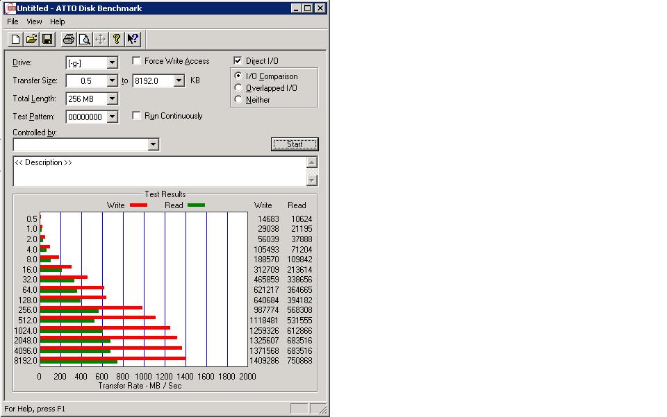

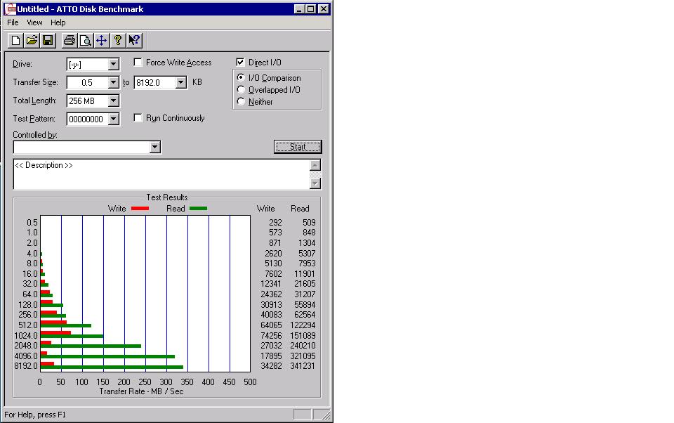

Some Benchmarks from our HA Set:
Benchmark on the first Starwind SAN on the Target partion

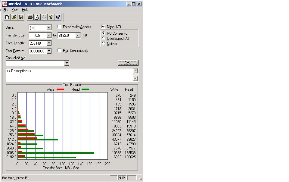

Benchmark from Hyper-V Node on the same ClusterSharedVolume

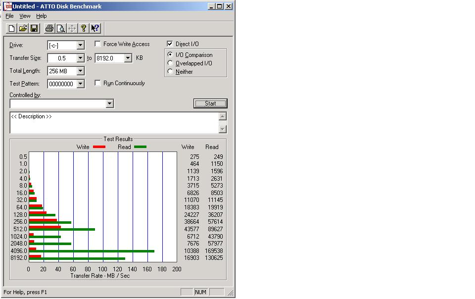

Benchmark from within a Hyper-V virtual Machine
