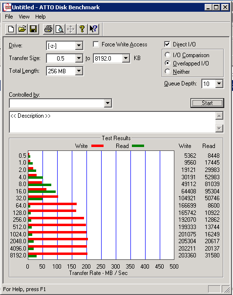

Max, when I setup my servers the first thing I do is setup Jumbo frames, so I decided to double check my results. Seems like a gremlin might have changed my Jumbo Frame settings :twisted:
Attached is the new benchmark results with Jumbo frames corrected on all NICS, however we are still experiencing the same results.

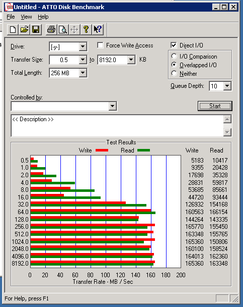

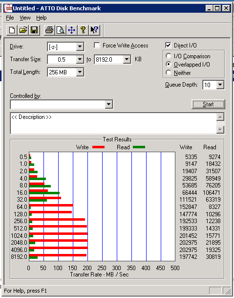

I just got some strange results, on Windows 2003 Target it seems to be working as expected, however the strange behavior is only being experienced in the Window 2008 R2 targets.
Windows 2003 Target
Windows 2003 Target
Windows 2008 Target
Windows 2008 Target

That is exactly what I am experiencing. 2008 and 2003 Vm's are fine, but 2008 R2 VM's are acting screwy. Unless it is just a coincidence which is possible. I don't know how to narrow it down further from here. Probably need to open a support case.
