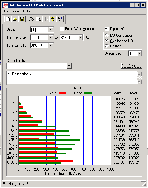

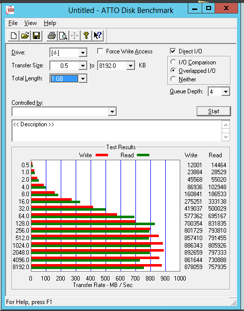

Sure. Both are 6 x 512GB Samsung 840 Pro SSD's in RAID 10, 64k stripe, GPT partition set to 64k, 2GB of Starwind Cache
One is Server 2008, no i/o accelerator, second is server 2012 with loopback accelerator installed.
Screenshot shows different test lengths but they were the same, I had changed that drop down box before taking the screenshot but after the test had run.
Srv2012 SSD RAID 10 2GB CACHE.png (20.05 KiB) Viewed 12256 times
Srv2008 SSD RAID 10 2GB Cache.png (20.38 KiB) Viewed 12255 times
Mon Apr 22, 2013 9:24 pm
That's a real difference! Thank you!
