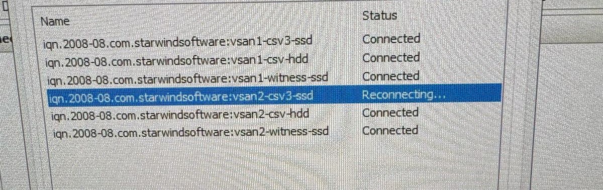

The storage is availabe and it does switch path if iSCSI initiator is "active". Do you see the CSV going offline?
NOP, I see only reconnecting message to one CSV out of 3 and this CSV hosts most of the VMS.
starwind reconnecting.jpg (253.33 KiB) Viewed 29862 times
After rebooting the storage, everything will be healthy. it is happening once per week.
there is a network misconfiguration, most probably or MPIO is not working well.

12/21 21:15:36.125932 13b0 HA: HASyncNode::registerSession: Return code 21.
12/21 21:15:36.125950 13b0 Tgt: *** iScsiTarget::openSession: iqn.2008-08.com.starwindsoftware:vsan2-csv3-ssd: can't register session. The device 'HAImage1' is not ready.
12/21 21:15:36.125964 13b0 T[f202,1]: ***iScsiTask::startLoginPhase: *ERROR* Login request: device open failed.
12/21 21:15:36.126090 13a0 C[f202], IN_LOGIN: iScsiConnection::doTransition: Event - LOGIN_REJECT.
12/21 21:15:36.126343 13b0 Srv: *** SwSocket::Recv: Swn_SocketRecv() failed with error 10054 (0x2746)!
12/21 21:15:36.126372 13b0 C[f202], IN_LOGIN: iScsiConnection::recvData: Recv returned 10054 (0x2746)!
12/21 21:15:36.126387 13b0 C[f202], IN_LOGIN: iScsiConnection::receive: recvData returned error 10054 (0x2746)!
12/21 21:15:36.126471 1c8 S[f202]: iScsiSession::~iScsiSession: ~Session
12/21 21:15:36.150488 9c8 IMG: ImageFile_IoCompleted: Warning(Time FileIO): request(0x0000007DA01A00D0) ssc(0x0000007DB59A5750) function(Execute SCSI Command) opCode(0x8A), timeFileIO = 13458 ms, g_cmdExecTimeWarningLimitInSec = 3 s. Device: 'E:\SSD Storage\SSD Storage.img'
12/21 21:15:36.150519 9c8 IMG: ImageFile_ScsiCompleteRequest: Warning(Time Request EXEC): request(0x0000007DA01A00D0) ssc(0x0000007DB59A5750) function(Execute SCSI Command) opCode(0x8A), timeExecRequest = 13458 ms, g_cmdExecTimeWarningLimitInSec = 3 s. Device: 'E:\SSD Storage\SSD Storage.img'
12/21 21:15:36.150544 9c8 Common: CStarWindStorageDevice::AsyncReadWriteCompleted: Underlying storage request(0x0000007DAD3C1F60, opcode 0x8A) execution time is 13437 ms.
12/21 21:15:36.150570 9c8 func: >>> HANode::reportEvent
12/21 21:15:36.150596 9c8 func: >>> iScsiServer::sendNotification
12/21 21:15:36.150615 9c8 func: >>> CEventDataBase::AddRecord
12/21 21:15:36.150634 9c8 EventDB: CEventDataBase::AddRecord: Code 809, severity 2, additional strings: 3
12/21 21:15:36.150691 9c8 func: <<< CEventDataBase::AddRecord
12/21 21:15:36.150711 9c8 Srv: iScsiServer::sendNotification: Send reaction start (reaction type 2, msg code 809).
12/21 21:15:36.151188 9c8 Srv: iScsiServer::sendNotification: Send reaction finish.
12/21 21:15:36.151223 9c8 func: <<< iScsiServer::sendNotification
12/21 21:15:36.151248 9c8 func: <<< HANode::reportEvent
12/21 21:15:36.151267 9c8 HA: Ssc_Request_Task::complete: Warning(Underlying storage): sscRequestTask(0x0000007DAD3C1F30) storageRequest(0x0000007DAD3C1F60) GeneralFunction(Execute SCSI Command) GeneralOpCode(0x8A) ex(0x0) buf_size(262144), StorageOpCode(0x8A), StorageDiffTimeCompleteEXEC = 13437 ms, DiffTimeCompleteINIT = 13437 ms, DiffTimeCompleteEXEC = 13437 ms. Current target: 'iqn.2008-08.com.starwindsoftware:vsan2-csv3-ssd'
12/21 21:15:36.235590 9c8 IMG: ImageFile_IoCompleted: Warning(Time FileIO): request(0x0000007DA01AF980) ssc(0x0000007DB0C92660) function(Execute SCSI Command) opCode(0x8A), timeFileIO = 13537 ms, g_cmdExecTimeWarningLimitInSec = 3 s. Device: 'E:\SSD Storage\SSD Storage.img'
12/21 21:15:36.235623 9c8 IMG: ImageFile_ScsiCompleteRequest: Warning(Time Request EXEC): request(0x0000007DA01AF980) ssc(0x0000007DB0C92660) function(Execute SCSI Command) opCode(0x8A), timeExecRequest = 13537 ms, g_cmdExecTimeWarningLimitInSec = 3 s. Device: 'E:\SSD Storage\SSD Storage.img'
12/21 21:15:36.235648 9c8 Common: CStarWindStorageDevice::AsyncReadWriteCompleted: Underlying storage request(0x0000007DAD5B0990, opcode 0x8A) execution time is 13531 ms.
12/21 21:15:36.235669 9c8 func: >>> HANode::reportEvent
12/21 21:15:36.235690 9c8 func: >>> iScsiServer::sendNotification
12/21 21:15:36.235709 9c8 func: >>> CEventDataBase::AddRecord
12/21 21:15:36.235728 9c8 EventDB: CEventDataBase::AddRecord: Code 809, severity 2, additional strings: 3
12/21 21:15:36.235782 9c8 func: <<< CEventDataBase::AddRecord
12/21 21:15:36.235801 9c8 Srv: iScsiServer::sendNotification: Send reaction start (reaction type 2, msg code 809).
12/21 21:15:36.236220 9c8 Srv: iScsiServer::sendNotification: Send reaction finish.
12/21 21:15:36.236254 9c8 func: <<< iScsiServer::sendNotification
12/21 21:15:36.236274 9c8 func: <<< HANode::reportEvent
12/21 21:15:36.236297 9c8 HA: Ssc_Request_Task::complete: Warning(Underlying storage): sscRequestTask(0x0000007DAD5B0960) storageRequest(0x0000007DAD5B0990) GeneralFunction(Execute SCSI Command) GeneralOpCode(0xF2) ex(0x0) buf_size(262144), StorageOpCode(0x8A), StorageDiffTimeCompleteEXEC = 13531 ms, DiffTimeCompleteINIT = 13531 ms, DiffTimeCompleteEXEC = 13531 ms. Current target: 'iqn.2008-08.com.starwindsoftware:vsan2-csv3-ssd'
12/21 21:15:36.251100 b84 func: >>> HANode::onScsiOp_CustomControl_HeartbeatPing
12/21 21:15:36.251967 b84 Common: CStarWindStorageDevice::hangedTaskExist: Storage device hanged operation: location = E:\SSD Storage\SSD Storage.img, request = 0x0000007DA60DEAC0, cdb[0] = 0x8A, cdb[1] = 0x00, buf_size = 262144, execution time (13234 msec) more than timeout (9000 msec)!

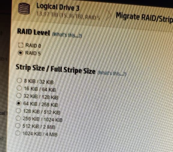

4. Do you have write-back cache on your devices?
We have write-back cache enabled on the raid controller for this SSD logical volume / RAID5
Also, the strip size/full stripe size for this volume is 64KiB/256KiB. is this an optimal value for SSD logical volume?
Also, we have HPE SSD Smartpath enabled for this logical volume.

i'm confused about the strip size / full stripe size configuration.
as per SW recommendations stripe size for SSD / RAID5 configuration is 64kb
are these the right settings?
strip size full stripe size.jpg (116.74 KiB) Viewed 28589 times
Posts: 3598
Tue Feb 27, 2024 8:33 pm
There could just too much I/O arriving to the VSAN. And as a result the threshold could have been exceeded. Can I please have the full set of logs from both nodes collected with log collector (https://knowledgebase.starwindsoftware. ... collector/) so I can look into the issue?
