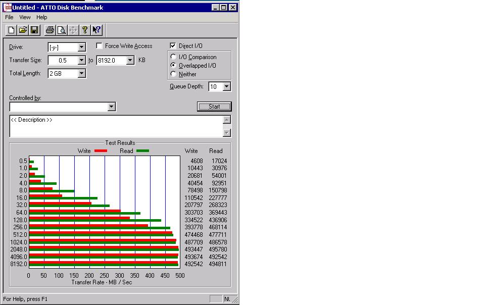

starneo wrote: Now everything is running really smooth and quite fast. I have done a ATTO diskbenchmark on all 4 CSV HA targets simultaniously (queue depth=10, 2GB size) and received 26000 I/Os at the Starwind Performance Monitor (overall). I know physically this is not passible (for our Storages), but with over all 30GB Cache (18GB for Starwind and 12GB on each Raidcontroller), it can be true :))
Wow! These numbers have completely blown me away!
I wish I could have those numbers.
Oh well, there are still some issues to iron out for me, in terms of the drop in performance only at 1KB and 2KB.
The rest is working fine for me.
The overall performance is good.
I am not sure if the performance ist good or not good at 0.5 / 1 / 2 / 4KB but its nearly dubbles everytime.
See the Screenshot - it is from a Hyper-V node on one Starwind HA-Target with 10 parallel I/Os.
One thing I forgot, after changing the setting the benchmarkfile is written with aprox 250-300MB/s to the CSV, it was only at 25-30MB/s before.

@starneo
The numbers are good.
I get about half those numbers using 2 NICs with MPIO.
A single connection should give you about 120-125MB/sec maximum (and only with sizes above 512K.)
So, basically, with MPIO, you should multiply those numbers by the number of NICs.
Congrats! You're there with your system!
