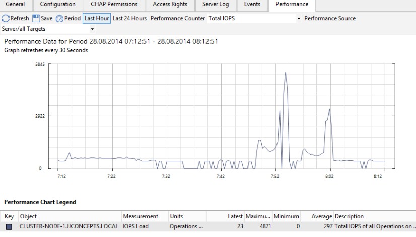

So here are my results. This is an active production cluster so keep this in mind. Also the tests were run separately and not at the same time
Jason
NODE 1 (running about 25 VMs morning time low load)

EDIT.. I am adding the Performance Graph from node1 from Starwind during that test. You can see the current load and the "jump" during the test.
IOPS-starwind load.jpg (69.37 KiB) Viewed 18739 times

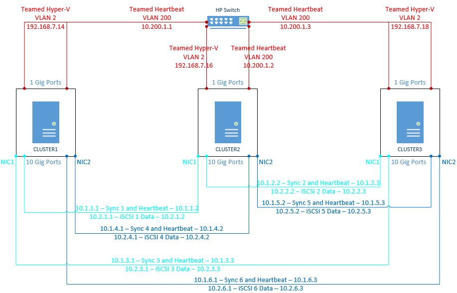

upgraders wrote:I don't know if this helps you, but I have almost the exact same server 3 Node setup that Anatoly from Starwind helped setup just last week and I am using direct connect. I have two Dual 10GBe Nic's (4 total per server) also two 300GB 10k sas as a RAID 0 for the OS and siz 900BGGB sas in Raid 0 for Starwind About 5TB. H700 Raid card with 1GB cache. I am also using a 12TB RAID 5 Synology SAN/SAS for Backups. My Dell R710s have four 1GB nics two of which are for the HyperV to the external network and the other two are the iSCSI for the Synology. I'm running Windows 2012R2.
Jason
Do you have MPIO for the iSCSI with this design? Just trying to understand what your 10Gbe Intel iSCSI is for when you said that your have two 1Gbe ports on each server for iSCSI to the Synology. I have almost the exact same configuration but I'm having problems getting the MPIO setup for the iSCSI. I designed my converged setup with two IPs per 10Gbe port so that the sync and iSCSI share each physical port. Should I make it simpler by dedicating each 10Gbe NIC port to either iSCSI or sync?

" Just trying to understand what your 10Gbe Intel iSCSI is for when you said that your have two 1Gbe ports on each server for iSCSI to the Synology." did you look at my diagram and few posts back?
I suppose you could call it over kill but I wanted all of my 1GB available for the NAS, but the Throughput for iSCSI is crazy fast using the 10GBe cards. The Synology is for backup, (I had a 2 channel iSCSI from it to a 1GB swtich dedicated and then connected to each Node) So 2 of the 4 1GBe ports were for the iSCSI synology. The other two were for local network. I have since changed the Synology back to a NAS rather than using Iscsi. Mainly I did this because best practices says you should ot use a CSV for backups (I use Hyper-V backups) and they were failing. They said since I was using the Synology for a CSV they would not support the failed backups. All is good now though, I still get 100mbps+ transfers.
I would not cross traffic on the same nic, that's me personally. Starwind guys treat the sync as sacred. not to say you cold not do it, but you are creating a single point failure too. If your nic goes out or something happens you loose both the Sync AND the iscsi connection.
If you only have one 10gbe port (Assuming you have a Dual two port per server) You want the FASTEST running the Sync dedicated. IF you don't have another 10GBe nic (they are only abour $350 on ebay for good Intel brand) then I would look at a 4 port Broadcom (I actually have some that are on ebay right now as that was what I was going to do prior to the 10Gbe for the iSCSI) this way EACH server has two iSCSI ports to help increase throughput (you can team them) 2GBe is better than 1 :) and there is failover.
Hope this helps
Jason

upgraders wrote:You have to have MPIO turn on.
Hope this helps
Jason
Yes I do have MPIO turned on. I have the same setup as yours with four 10Gbe ports (dual 2 port Gbe NICS) on each server. The reason why I have both sync and iSCSI on each 10Gbe link is exactly for having no single point of failure (I'm basically assigning two IP addresses per 10Gbe port). I might be missing something, but if your 10Gbe fiber on Node 1 goes down, you lose all your sync to Node 1 but the Intel iSCSI stays up correct? In my setup, if the first 10Gbe NIC dies I lose both my sync and iSCSI on that NIC, but my second NIC also has both sync and iSCSI configured so in theory nothing goes down.
This is my configuration that I'm trying to get working:

You are crossing traffic so two separate sync channels and iscsi... hum I dunno I think I'd like to hear Starwind chime in. I would think you would not want to mix traffic or what that would cause (caveats) ? but yes you are right since you have two sync and iscsi and one goes down in that configuration you would not lose, but I am not sure.. perhaps that's why you can't get MIPO working?? if you used nic teaming with one IP so that failover would happen automatically that may be an option. My configuration was drawn up by Starwind a few years back and ok'ed by Anatoly so I would think if there was a better configuration he would have done it that way. Ive been running with this setup for about a month now and I am very pleased.
Jason
