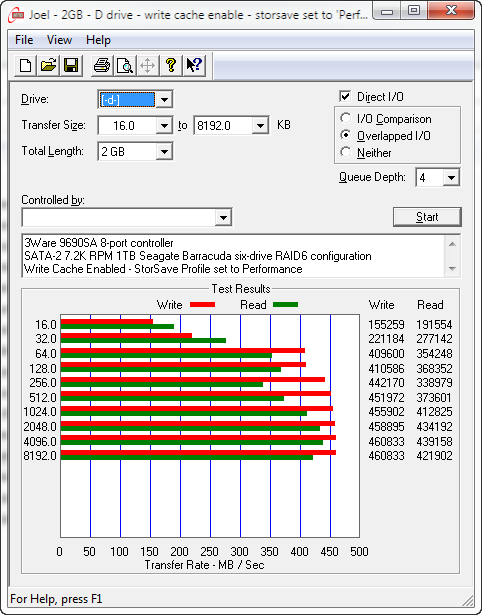

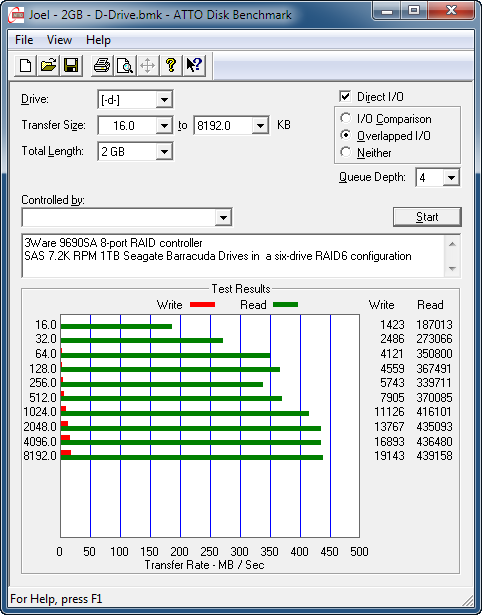

So the main problem turned out to be simple: I didn't have write cache enabled on the controller. Before I discovered that I ran the Atto disk benchmark on the storage server itself (no iSCSI, no VMWare -- just direct attached storage. I got the results in the first (a screenshot from Atto). The write performance leaves a bit to be desired ....
No write cache
No write cache
After discovering that write cache on the controller was disabled, I turned it on and immediately saw an improvement in the benchmark, as shown in the second image.
Write cache enabled
Write cache enabled
...which looks a lot better.
