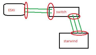

1. Starwind server connected to 1Gbit switch with 3x 1Gbit NICs (all NICs used for iscsi traffic). To the same switch ESXi host with 2x 1Gbit NICs connected.

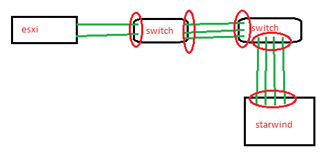

2. Starwind server connected to 1Gbit switch with 4x 1Gbit NICs (all used for iscsi). To the same switch would be second switch connected (with 2x 1Gbit ports used). To this second port ESXi host with 2x 1Gbit NICs would be connected.
I don't know how should be these network parts (marked with red) configured, so MPIO works as designed. The only thing I would like to achieve is that I have enough throughput if needed by my servers. At this moment I do not plan HA setup (just single box).
What IP's should be used on Starwind ports? all in different subnets? If yes, then which IP's should be configured on ESXi servers to work correctly with MPIO?

dual switch config
dual switch config
single switch config

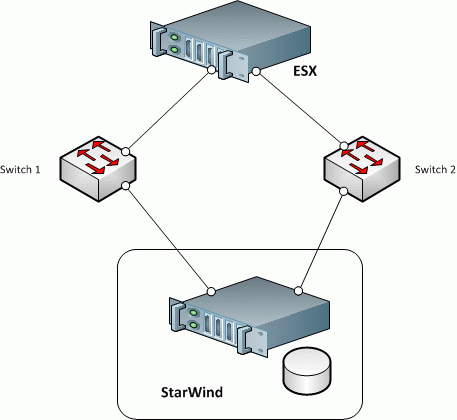

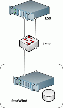

Both your interconnection diagrams are wrong. The one with two chained or stacked switches adds extra latency for packet re-route and has multiple points of failure (both switches). Singe switch overheated or just went FUBAR should result whole system going down. Second one with three links between switch and StarWind storage node has zero sense. How do you expect switch routing packets between 2 IPs on ESX and 3 IPs on StarWind? To have properly configured network you should have something similar to either first diagram attached below (the one with one switch) or second (with two switches). First one has MPIO configured with one switch being single point of failure and second one has fully redundant MPIO. Assign two NICs on ESX with IPs for example 192.168.0.1 and 192.168.1.1 and second pair on StarWind side with IPs 192.168.0.2 and 192.168.1.2.

Diagram 1 (MPIO configured with one switch).

Diagram 2 (MPIO configured with a pair of switches).

Indeed in that case (when only one switch is in place) i will connect equal number of paths to both esxi and starwind. That's clear. But second scenario is not clear to me. Second case assumes that esxi servers (3) will be located ~50m from starwind server. So i need to find out how to configure switches and host to provide over 1Gbit throughput if needed. Can you advise something?
Thu Jun 02, 2011 8:01 pm
What you need is called GbE repeater. There are plenty of them on the market. Unfortunately we did not had any chance to try them in the lab and we're not affiliated with any hardware vendor either so I cannot recommend anything in particular. Google is your friend here :)
If you really need to stick with multi-switch model make sure you have FOUR switches chained to form two fully redundant MPIO links. Something like:
ESX <--> switch 1 <---> switch 2 <---> StarWind
ESX <--> switch 3 <---> switch 4 <---> StarWind
Should work fine. With extra hop and increased latency but fine.
