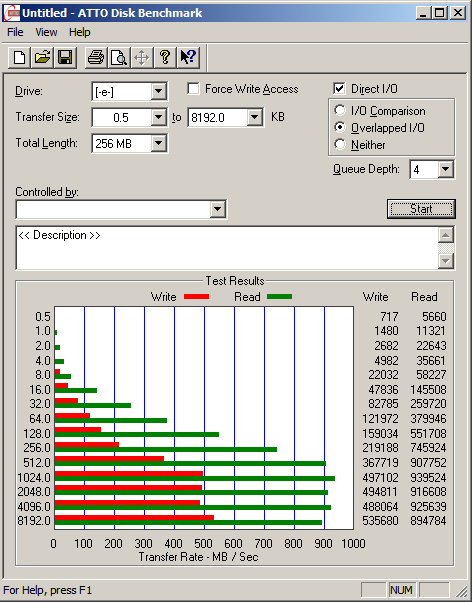

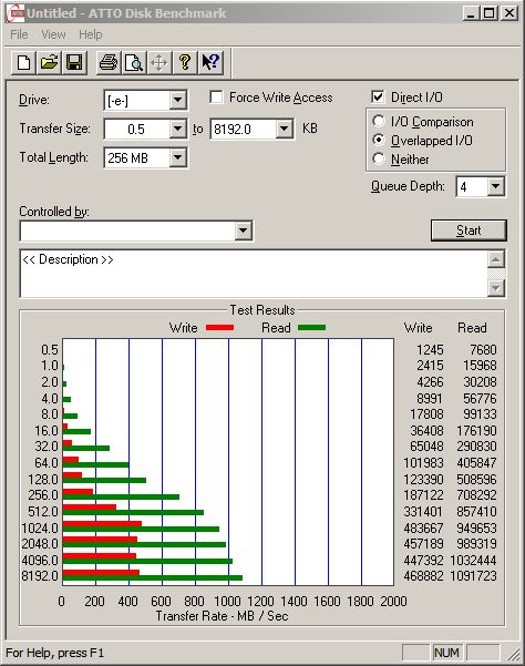

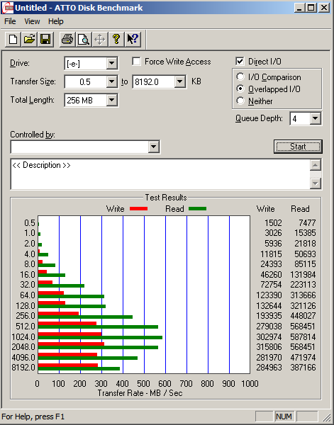

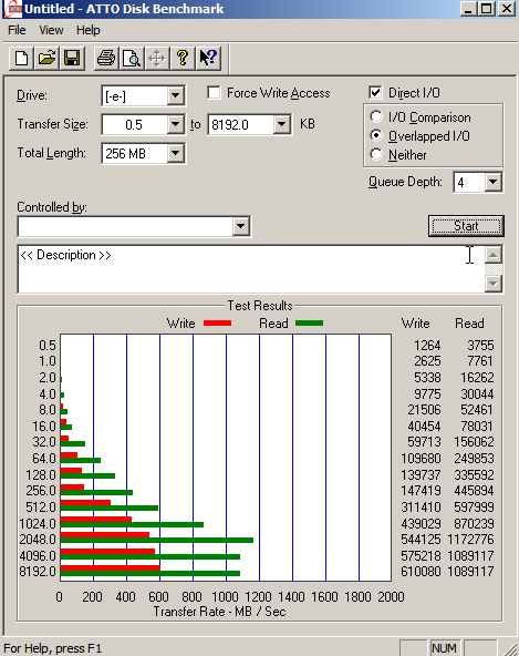

Image of the iSCSI Window where 5 connections are made locally and 5 remote to the second server
Detail of one of the iSCSI Connections (all look the same, except that for the local server there are 5 MPIO Connections and for the remote server there are the 5 sync connections + 5 MPIO Connections)

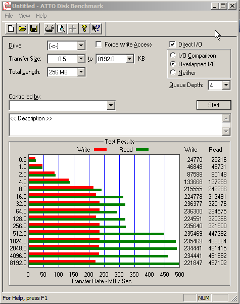

A standard ATTO run on the local disk to get reference values

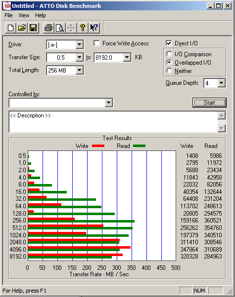

A standard ATTO run with only 1 iSCSI Connection to the locally running Starwind Server
A standard ATTO run with only 1 iSCSI Connection to the remote running Starwind Server (second server)
A standard ATTO run with 5 iSCSI Connections to the local Starwind Server with MPIO enabled
A standard ATTO run with 5 iSCSI Connections to the remote running Starwind Server (second server) with MPIO enabled
A standard ATTO run with 5 iSCSI connections to the local Starwind Server and 5 iSCSI Connections to the remote Starwind Server (second server) with MPIO enabled
The Servers are directly connected over a 2 Port Intel X520-T Network Adapter, cable length is 0,5 m Cat 6A, with NetIO I get around 1120 MB/s per Port - I haven't bonded them

Here are the other 3 test runs
I've no problem to provide you remote access additional images etc. I just need to know what you'd like to have, because I don't really know what exactly to look for

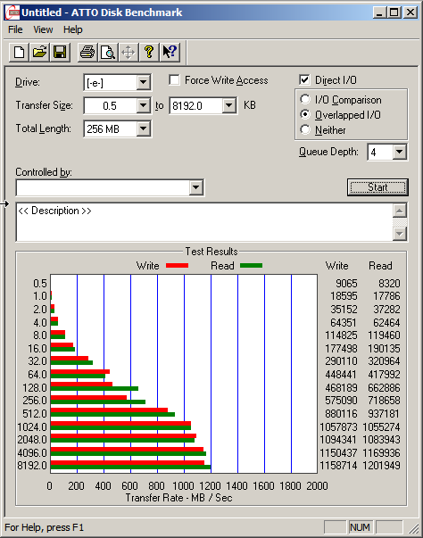

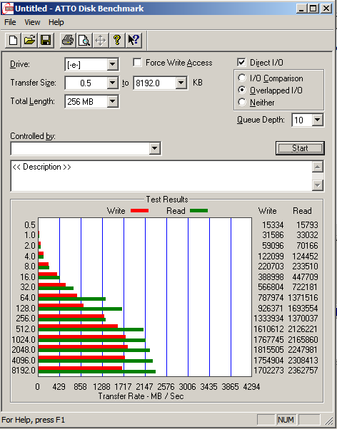

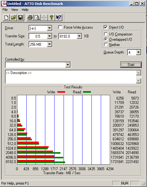

to check it again, I've tested with a RAMDRIVE of 5 GB here are my results:
the Access Time is quite good with 0.5 ms, but the small reads/writes just plain suck :(
6 connections, 3 over port 1 and 3 over port 2, Queue Depth 10, and 256 MB Size
6 connections, 3 over port 1 and 3 over port 2, Queue Depth 4, and 256 MB Size
5 Connections over a Single Port of the X520-T, Queue Depth 4, and 256 MB size
Thu Oct 13, 2011 11:50 am
Compare local I/O and "networked" I/O. Separate numbers tell nothing.

yes that's why I made the first tests with the local hard disk test and the networked test to see what the difference is - I've read somewhere that the difference should be about ~10% - is that correct?
then I made the RAM Disk test to completly ignore the physical disk hardware - but also that drive is slow with the small data chunks, so either the network adapter is doing something wrong or the iscsi initiator or starwind
I don't really have comparison values with other systems, but I think my results are odd
I do have another question: is there any way to improve the loopback performance?
Thu Oct 13, 2011 12:21 pm
No it's not correct. You do insert a latency for network and request processing. So on fully booked pipeline when you fire multiple requests in a deep queue there will be no difference in local and networked I/O. But for a short "bursts" you need to add network latency and request processing latency on both sides. Can result 2x - 4x performance degradation.

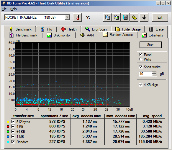

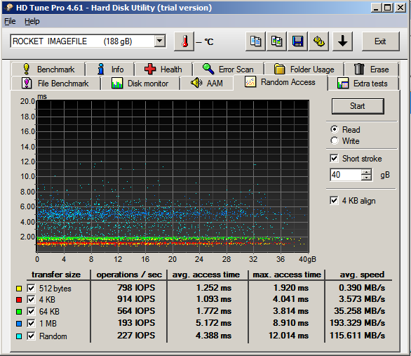

And through the various tests I've noticed one thing that really bugs me:
MS Initiator Access Times
Starwind StarPort Access Times
As you see the MS Initiator takes quite a time on the max. Access Times, with your (the Starwind StarPort Initiator) the maximum access times are much better, but not as good as on the real device (add network lat. etc)
