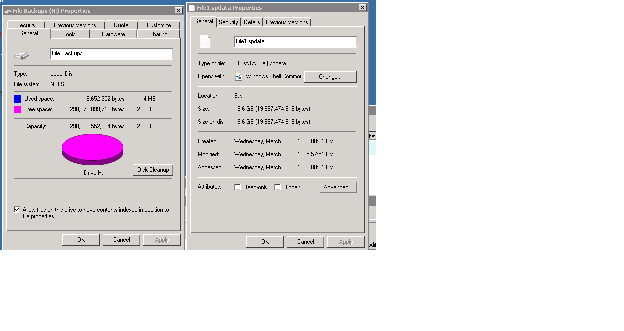

after delete all the files from one starwind iscsi volume, Starwind data file size reminds unchanged, see attached screenshot.
Sun Apr 01, 2012 6:28 pm
Dear cellardoor,
Me and my honorable colleague were asking and suggested you something. Can you please comment this somehow?
About your question - yes, it shouldn`t shrink after data was erased by design for now.
olivierolejniczak
