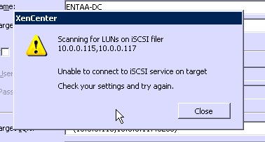

The issue i am running into which is also not the way i am presenting storage to my previous installs is when adding the shared storage in xencenter. it states the final attachment wizard using SAN1 and SAN2 IPs in the target host like so. 10.0.0.115,10.0.0.117 and then selecting the (*10.0.0.115,10.0.0.117:3260) as the IQN but no matter how i do this i always get a unable to connect to iscsi service on target error when discovering the LUN.

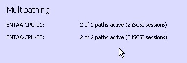

I am able to attach the storage how i am in the older 5.6 install guides by just pointing to the IP of SAN1 and manually running some iscsiadm commands to be sure things are attached prior to adding to xencenter. adn multipathing still says 2 of 2 paths. which can be a little picky sometimes and revert to 1 of 1 after a xenserver reboot in the pool.

Tue Apr 24, 2012 2:59 pm
So just to clarify - you are getting error when trying to connect to the HA, correect?
Can you please provide us with the screenshot of the error?

when clicking the discover LUNs i get the following.
i just tried the secondary method in the PDF via command line and it completes with no errors. but this is what i see as far as actual connections.

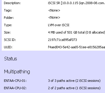

I just ran through the process i use to connect HA storage using multipathing on previous installs which is.
create ha target
run following commands on each CPU node
iscsiadm -m discovery -t sendtargets -p 10.0.0.115
iscsiadm -m node -T iqn.2008-08.com.starwindsoftware:10.0.0.115-entaa-dc -p 10.0.0.115:3260 -l
iscsiadm -m discovery -t sendtargets -p 10.0.0.117
iscsiadm -m node -T iqn.2008-08.com.starwindsoftware:10.0.0.117-entaa-dcpartner -p 10.0.0.117:3260 -l
then add storage in xencenter pointing to the SAN1 IP 10.0.0.115
and it attached. but out of the gate this is what i see for its multipathing settings.
which technically should work. but with the number of nics and such on this system i think the proper number for multipathing is 4 of 4 with 2 active sessions.

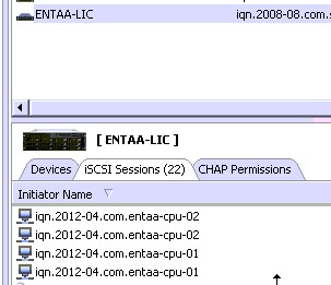

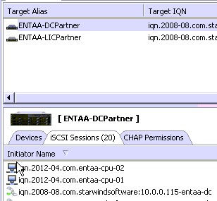

Thu Apr 26, 2012 8:25 pm
OK, I will definitely ask you to provide us with the network diagram with all hte IPs and iSCSI session that you created because number 20 that we see in SW console looks too big for me.
