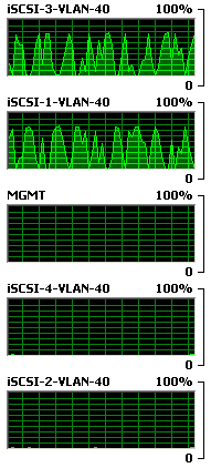

This one presents what is happening with network cards - data transfer complement each other! When one is maxed out second one is equal to zero...

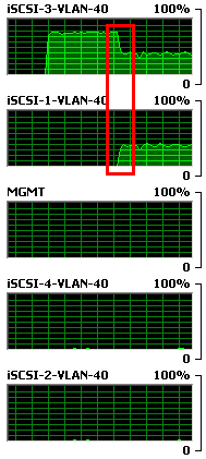

Third screenshot shows what is happening when the same command is issued when multipathing policy is set to fixed and during transfer changed to round robin. In the beginning one channel is used and that's expected. But when policy changes transfer is equally split between both paths but the sum remains same as for single path (1xGbE). I admit I expected to see that transfer speed doubles...

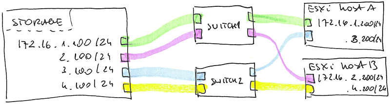

I've checked connections once more as you suggested but everything seems to be fine. My topology:

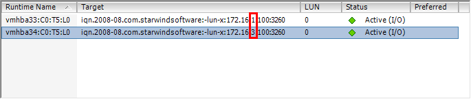

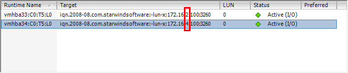

Next two screenshots present paths configuration for both hosts. You can easily see that target IP is different for each hba.
Paths - host A.png (4.33 KiB) Viewed 17715 times
Paths - host B.png (4.35 KiB) Viewed 17715 times

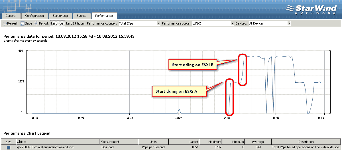

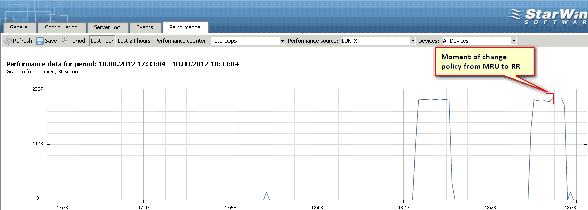

Two screenshots presenting what is happening on iSCSI target during my tests.
First one shows that starting dd on ESXi host B when ESXi host A is dding doubles number of IOPS. Both hosts are using RR policy.
Second shows what is happening when I changed MRU policy to RR during dd. This slightly increases number of IOPS.
