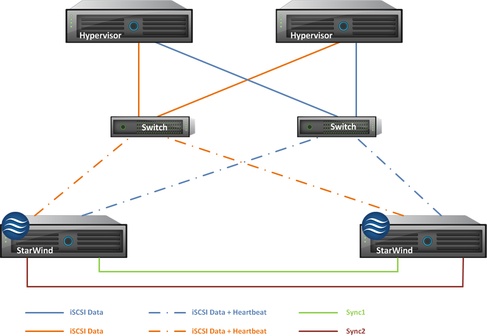

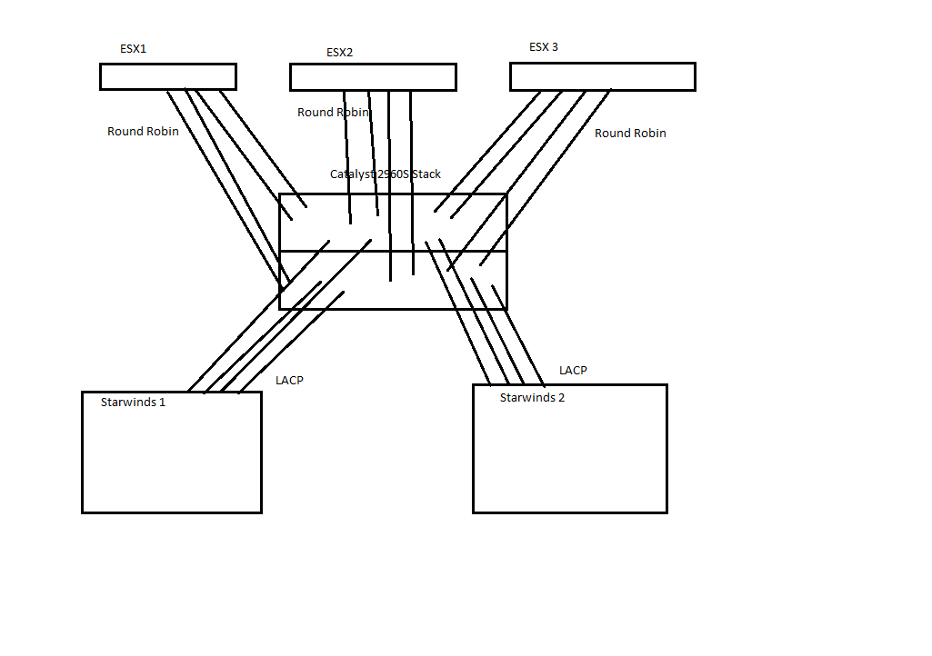

1) Could you please show us your interconnection diagram?
Something like on the attached image. You may use paint, viso, or even scanned freehand picture.

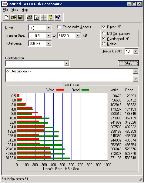

2) Is it possible for you to try also ATTO Disk Benchmark (against the local disk and then against the connected via iSCSI) which also does not require a PHD to run :lol:
http://www.attotech.com/products/produc ... _Benchmark
try the default queue depth 4 and then 10

Attached is the diagram for our setup. I will run the benchmarks you requested shortly and post results.
EinsteinTaylor
Posts: 22
Joined: Thu Aug 30, 2012 12:28 am

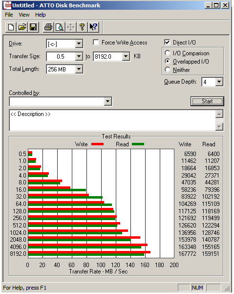

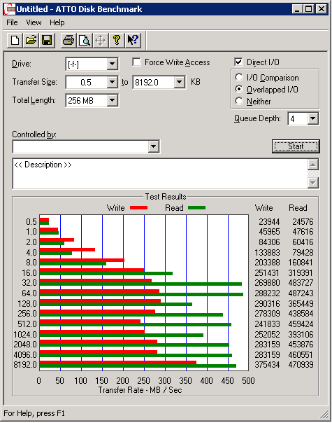

Thu Aug 30, 2012 4:11 pm
Local server, queue depth 4:
Local server, queue depth 10:
VM, queue depth 4
EinsteinTaylor
Posts: 22

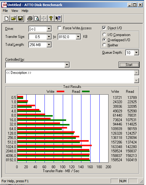

Thu Aug 30, 2012 4:12 pm
VM Queue depth 10:

I don't see dedicated synchronization channels on your diagram.
Does it mean that you use LACP channels both for iSCSI Data traffic and HA synchronization traffic ?
The total bandwidth of synchronization channels on each HA node should be equal or bigger than total bandwidth of incoming iSCSI data channels. In your case with 4 iSCSI data channels it should be 4 sync channels or bigger.

We are performing synchronization over the same bonded nic as the iSCSI data, although for the test in question it *is not* an HA target/device. This is just a simple virtual image file presented as a single target. There is currently no VM's on our HA target so I/O and sync activity should be at a minimum

OK, let's try one more test: on StarWind server create RAM disk target (1-4 GB) and connect it with iSCSI initiator on other machine over the network, run ATTO disk benchmark. This test most directly measures the network because RAM disk performance is higher.

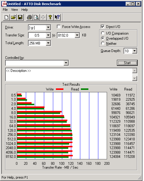

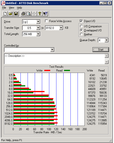

I ran the iperf commands you listed and was able to saturate a gigabit link every single time. I have created a 4GB RAM disk on one of the starwind servers and used the Microsoft iSCSI initiator on the other starwind server to mount the RAM disk. I am attaching the output of ATTO with queue depths 4 & 10. Unfortunately I don't know enough about ATTO to interpret the output so I could probably use a little help there, although watching the bandwidth graphs in task manager, I am seeing it around 22-24% which with a 4 NIC bonded link sounds like it's saturating 1 gigabit line(which is what you would expect for only a single connection).

On ATTO screenshots you can see that the maximum performance is limited by 123 MB/s ( which is the performance of 1Gb interface because 1Gb/s ~ 120-125 MB/s).
In order to get higher values I would suggest you to use 4 standalone connections and MPIO instead of LACP
