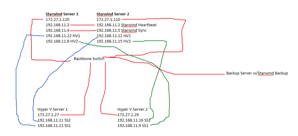

Our setup is a standalone 2012 Server with the console installed on it. Then there are two Hyper V servers 2012 it is suppose to backup. We have no firewalls internally to block traffic.

Can I ask you for some clarifications from you if you don`t mind:
- May we see your network configuration (the visio diagram with explanations prefered)?
- Are all the servers are participating in one domain?
- Can you confirm that all ports that backup plug-in is using (by default its are 9090 and 3261) is opened in any firewalls that are running on machines?

Yes on one domain, and there are no firewalls internally, we only use one at the Internet level.
I attached a basic drawing from OneNote as I don't have Visio. Granted there are other servers and equipment, but everything is connected to that backbone switch, there are currently no VLAN or separate subnets.
