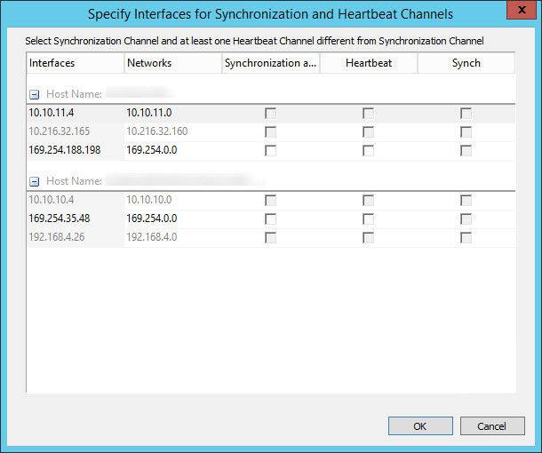

Has DR replication been released? I just downloaded latest build and trying to setup replication between Primary and DR site and all of the check boxes for IPs when setting up "Interfaces for Synchronization and Heartbeat Channels" are greyed out.
Primary and DR sites are using different subnets and I can't use work around proposed to extend the same subnet across WAN.

Could you please drop me the full screenshot of the corresponding window?

Fri Aug 22, 2014 5:52 pm
Anatoly (staff) wrote:Could you please drop me the full screenshot of the corresponding window?
Please see screenshot below.

Heartbeat/sync channels between nodes must be sharing the same subnet. DR replication has not been released yet as the final version - we will include some improvements.
