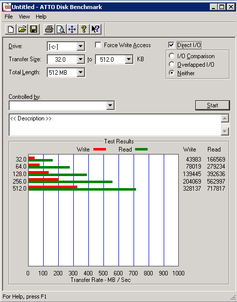

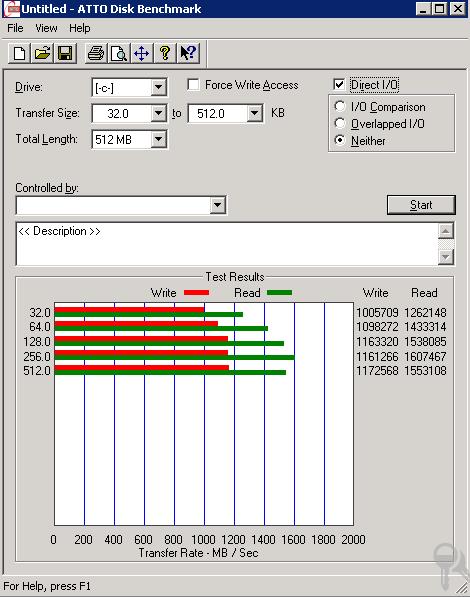

I have discovered after testing our v8 SANS that when you compare write performance of a virtual disk running on a Single SAN, with a virtual disk running in a 2 node sychronous HA configuration, that the write performance of the synchronous storage is around 50% or less as show below.
Is this normal behavior for HA storage? If I was to add a tertiary node are we to expect another 50% write reduction? What should be the expectation?

Rob is absolutely correct: you have one extra network "hop" in between the nodes as packet P delivered to Node A needs to be sent from Node A -> Node B and confirmation received before Node A would actually fire back confirmation "data is here" to original caller. So YES writes will be slower in HA config then in non-HA one (reads are another story their performance do INCREASE because amount of independent MPIO paths to the same mirrored data is increased). How slow? It depends on a) how fast backbone connection really is (Rob is correct again) so running symmetric config is not recommended, always use something MUCH faster for backbone (we don't need switches for that so setup is kind of an inexpensive one) and b) how loaded your config is. See normally you have a pipeline so with a reasonable long queue (you'll never see less then ±64 commands pending in Hyper-V or vSphere write queues) commands are handled in the different stages of completion: command N is just fired from caller to Node A, command N - 1 is under way of being delivered from Node A -> Node B, command N - 2 is returning ACK from Node B -> Node A and command N - 3 is reported "done" by Node A to caller. ATTO Disk Benchmark is by far the best tool to measure performance here so we always recommend either Intel I/O Meter or your production config simplified (better - AND and not OR). However... In your case numbers are TOO low even for ATTO so I'd suggest to welcomed our engineers on a remote session to see what could be improved (I don't like reads did not increase and actually decreased which means MPIO is not kicking in for some reason, that's already a "full stop" here).

I turned on Direct I/O on my benchmarks and bypassed any write caching on the virtual machine to get some better statistics on the ISCSI. When I use the default settings the "production performance" benchmark does improve to more acceptable levels, but we can thank windows & RAM for that, and not the starwind storage network. The reality is, it reveals how badly writes do suffer in a multi-node HA environment. I realise this problem isnt necessarily unique to Starwind and I am just floating it on the community for ideas of how to improve it, as it is a limitation of highly available storage and preventing write heavy customers from embracing this kind of storage technology.

1) Symmetric config is when uplinks from your hypervisor hosts are the same as a backbone between storage HA nodes.
2) "Direct I/O" on ATTO does not bypass cache. Also you should be using Overlapped I/O policy and not Neither as you get a huge latency between multiple I/Os fired by benchmark. VMware does not work this way.
3) Yes, we'll do native InfiniBand soon. But in your case issue is in another place.
4) Before diving deeper into details please provide a) diagram for interconnection and some config details (so we would not guess what hypervisor you use, are you hyper-coverged or "Compute and Storage Separated", what storage back end you use - FLAT or LSFS, what caches you run etc) b) be ready to organize a remote session for engineers. Because from what I'm getting your setup should run much faster then it runs now.
5) Backbone: you're not going to get 100% utilization with a fast backbone and having "pulsating" traffic from single VM.

Well looking at the OP 512MB figures, they are getting a pretty good 1,100MB/s write speed @ 512MB block size. So *if* the network overhead is around 1,300MB then you've got two similar *sequential* I/O speeds.
So for writing a single 512MB block, then the total time could be TWICE the single node speed. 512MB block @ 1,300MB/s across the network and then 1,100MB to the disk. The return ACK won't take long as there is only a small abount of data going back.
