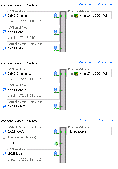

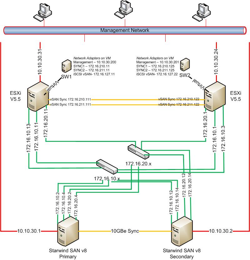

I had an existing HA infrastructure that I was taking offline, so I figured it would be a good testing bed to give this a try. I attached a quick rough diagram of the setup (allot is going on). I also attached the networking setup of one of the ESXi hosts.
Everything appears to function as it should, until I get to page 33 of the PDF with adding my dynamic IPs and scanning for the storage. I add the first Starwind node (SW1) from the virtual local network of 172.16.127.11. I add another IP address of the second Starwind node (SW2) from networks SYNC1 and SYNC2 (172.16.210.125, 172.16.211.125). I click OK, and rescan but my Starwind devices on my virtual starwind adapters do not appear.

vSAN config on ESXI host
esxi vsan network config.PNG (18.38 KiB) Viewed 12707 times
vSAN topology w/Starwind SAN
vSAN setup.jpg (81.99 KiB) Viewed 12707 times

ESXi 1 vmkernels
SYNC 1 - 172.16.210.111
SYNC 2 - 172.16.211.111
iSCSI VSAN - 172.16.127.111

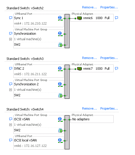

ESXi 2 vmkernels
SYNC 1 - 172.16.210.122
SYNC 2 - 172.16.211.122
iSCSI vSAN - 172.16.127.122
SW1
SYNC channel 1 - 172.16.210.11
SYNC channel 2 - 172.16.211.11
iSCSI vSAN - 172.16.127.11
SW2
SYNC channel 1 - 172.16.210.125
SYNC channel 2 - 172.16.211.125
iSCSI vSAN - 172.16.127.22

Page 3 shows in the diagram that the 2 physical cables between ESXi hosts have 2 IP addresses in different subnets on them. When I originally created this setup, I set it up with one IP address at either host for the SYNC channel - thinking the 4th NIC that doesn't have any physical adapters bound to it would be what is used for the iSCSI Data traffic. I completely overlooked the 2 IP addresses in that diagram.
I'm only assuming, that you are supposed to create 2 VMKernels per physical adapter on your ESXi host - one for the SYNC Channel and one for the iSCSI data. So that is what I did, but after I do an iSCSI Software Adapter rescan it finds no additional devices. I'm relatively new to ESXi 5.5 and it's latest capabilities, but I thought the only way that you could have a device show up under the iSCSI Software Adapter was to bind a VMKernel port to the iSCSI software adapter. So that is what I did next, I added the VMKernel iSCSI VMKernels to the iSCSI Software Adapter and once I did that and performed a rescan - boom there's my device on the SW virtual nodes.

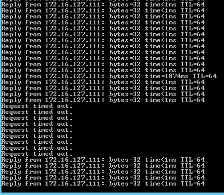

I'm not understanding what the point of the adapter that is added with no physical adapter bound to it - how does it locate the storage on the virtual SW nodes if it's not bound to the iSCSI Software Adapter? Also - one thing I noticed...when I do a ping from my virtual SW node to one of those adapters that has no physical adapter, it times out from time to time. I ping 172.16.127.111 from SW1 node, and it times out from time to time....responds...then times out.

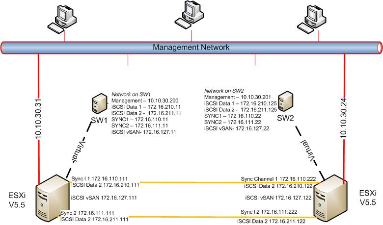

I attached an updated diagram of my setup, the network configuration on one of my ESXi hosts, and the ping response time from my SW1 node that is timing out during a continuous ping.
Ping response from SW1 node to iSCSI vSAN vmkernel on ESXi host
SW1 ping iSCSI vSAN vmkernel.PNG (56.26 KiB) Viewed 12683 times
ESXi setup v2
ESXi setup v2
vSAN esxi setup v2.PNG (18.78 KiB) Viewed 12683 times
vSAN setup v2
vSAN setup v2
vSAN setup v2.jpg (48.33 KiB) Viewed 12683 times

I resolved the ping timeout issue in my last post by removing the virtual VMkernal iSCSI network adapter from the virtual machine, and re-adding it as a VMXNET3 adapter. I no longer have any ping timeouts on the 172.16.127.* subnet.

I’m afraid that you configuration is not fully clear for me.
Let me suggest you minimal configuration that should work like charm and it will be understandable to all of us:
ESX1
vmKernel1 - iSCSI 172.16.210.11
vmKernel2 - SYNC 172.16.110.11
VM1
iSCSI - 172.16.210.100
SYNC - 172.16.110.100
ESX2
vmKernel1 - iSCSI 172.16.210.22
vmKernel2 - SYNC 172.16.110.22
VM2
iSCSI - 172.16.210.200
SYNC - 172.16.110.200
Try to add iSCSI disk.
If everything works, then proceed with adding another one SYNC channel or whatever you want.

Got it - I thought the same thing. So I scratched my entire setup and rebuilt it with your suggested setup below and it works now. I think I know why it wasn't working for me so my first question..
On the guide, page 5, it shows a virtual NIC with no physical adapters bound to it - what is that for? That's what was throwing me off, I thought I had to use that to access my virtual storage.
