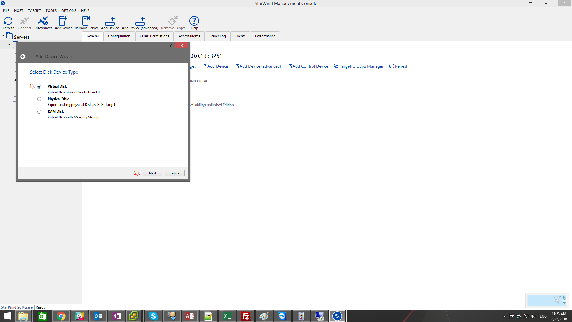

Ok, so I finally blew away FreeNAS (really... I wanted to blow it up). But after reading guide after guide, I have not found one that tells you how to setup your disks initially. They all seem to jump into creating the server, creating the iSCSI target, then adding devices. In following those guides, I could absolutely do all that... but what I got was three independent drives, each assigned their own LUN. So when I tried to add it to XenServer, the three drives would present three different LUNs as a choice... with no option to set the three up as an array of any sort.
I searched around some more, but came to the conclusion (maybe erroneously) that StarWind, in and of itself, does nothing to actually build arrays of any sort. It maybe only presents a currently existing physical device to a target, and goes from there.
Following that assumption, I used Storage Spaces in Server 2012 R2 to build a roughly ~4TB available parity array from the three 2TB drive pool. However, when I go to add that new drive (I gave it a drive letter and formatted it to NTFS), then add it to the target, I get a yellow exclamation over the target, and a red exclamation over "DiskBridge1" (not understanding the StarWind terminology just yet).
So... here's a screenshot. Please tell me what I'm doing wrong. :)

You have to choose Hard Disk Device -> Virtual Disk instead of Physical Disk option while creating a Starwind device. And you will be fine.
My concern here is that AFAIK Storage Spaces is aligned to 4K block size and for XenServer you have to use 512B block size devices... not sure it will work this way but give it a try! ;-)

Hi Cabuzzi!
These aren't the droids you're looking for (c) :D
In order to create your StarWind devices you should choose Virual Disk option in the "Add new device" manager. Please check the screenshot in the attachment :)
P.S: Our Xen documentation looks a bit outdated so I would like to advice you starting with our Hyper-V guide: https://www.starwindsoftware.com/techni ... manual.pdf in order to learn how to create StarWind devices and than move to Xen guide: https://www.starwindsoftware.com/techni ... Server.pdf after initial steps are finished.
P.P.S: Also please keep in mind that we are not yet officially support Storage Spaces and hardware RAID is highly recommended.

darklight wrote:You have to choose Hard Disk Device -> Virtual Disk instead of Physical Disk option while creating a Starwind device. And you will be fine.
Thanks. I figured I was missing something obvious. As for XenServer, I've heard this come up before, but it has never been any real issues as a result. There can be some issues with alignment, so I'm told... but nothing too noticeable on my end.
There is a good discussion of it here on the XenServer forums. Tobias (XenServer god) gives a good rundown on it:
http://discussions.citrix.com/topic/360 ... e-in-6265/
At any rate, when I built the virtual disk, it allowed me to choose 512 or 4096, so I chose 512 to be safe (someone chime in if this is wrong).

So... I've made some progress. I had to uninstall/reinstall SW because no matter what I did, I couldn't get the the management console to connect after I removed the old iSCSI stuff I erroneously built. Also, it did not ask me for a license key this time, but I do have it on the desktop. The option of Host > Install License is grayed out, so I'm hoping all is good there. No nag screens yet.
