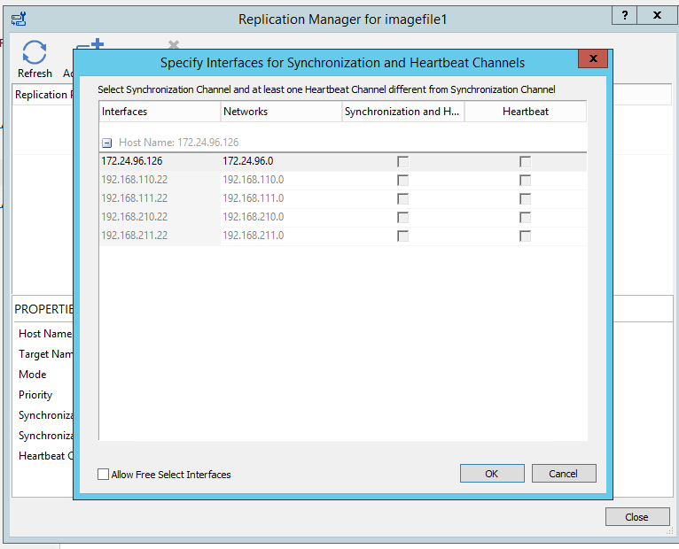

I am using the guide here: https://www.starwindsoftware.com/techni ... manual.pdf and when I get to step 19, I don't see any interfaces for my server (see image below). I just see them for the server that should be the replica. What am I doing wrong or not doing?

Fri Mar 25, 2016 6:45 pm
As far as I understood, you can see IP`s only from one node.
Could double check your NIC`s on each node?
Did you create your configuration as shown in the manual?
Getting started can help you with it too https://www.starwindsoftware.com/techni ... tarted.pdf

Fri Mar 25, 2016 6:48 pm
The configuration is like what is says to do in the manual. If I sign in to the other server, I see the IP address of the other server, so I see the exact same as I see on the first server.

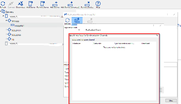

I have a similar problem to this post (in Windows Server 2016) so I ask here not to start another similar post.
The problem is that it does not load any interface in the sync channel list window.
no interfaces
no interfaces
I have checked the 5 points above.
What may be the cause of this problem?.
The solution is uninstall MS iSCSI target installed on the servers?. How can I do that?

Michael (staff)
Posts: 319
Sat May 13, 2017 8:31 am
iSCSI Target can be removed using Remove roles and features in the Server Manager. https://technet.microsoft.com/en-us/lib ... removerrfw
Choose File and Storage Services->File and iSCSI Services->iSCSI Target Server and follow the wizard.
The KB articles below should help you as well:
https://knowledgebase.starwindsoftware. ... d-console/
If you need iSCSI Target Server installed, you can follow the steps in this KB article as workaround: https://knowledgebase.starwindsoftware. ... ort-value/
