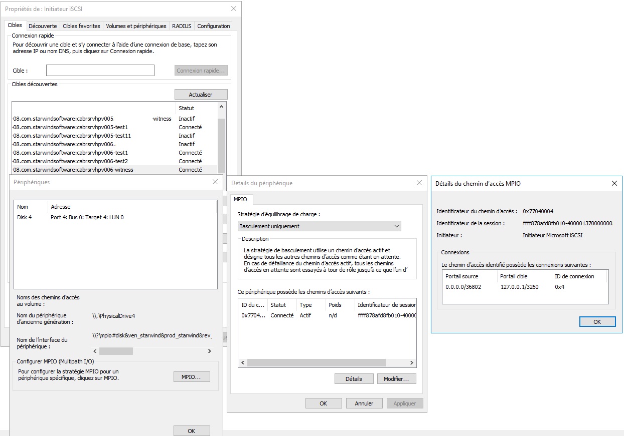

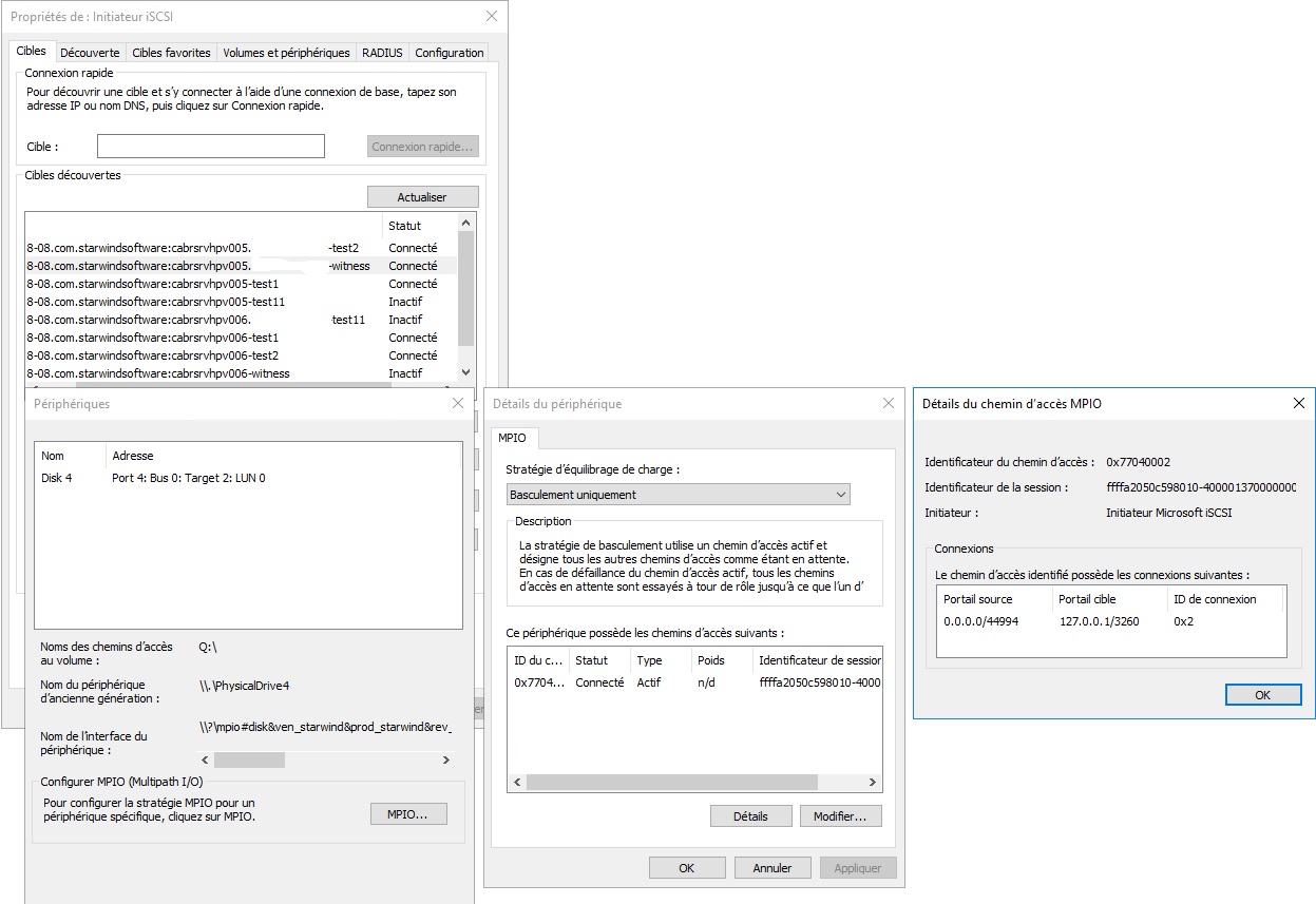

Could you confirm that Witness device is connected on both hosts in iSCSI Initiator via loop back (127.0.0.1) only?
Grypht
Posts: 6
Joined: Wed Mar 29, 2017 1:11 pm
Thu May 04, 2017 1:02 pm
Hi, I have checked a few times, but to make sure here are screenshots (sorry they are in french)
Host HyperV 5:
Host HyperV 6:
Does it seem OK?
Thank you

Fri May 05, 2017 7:30 pm
Hello
The configuration looks fine.
