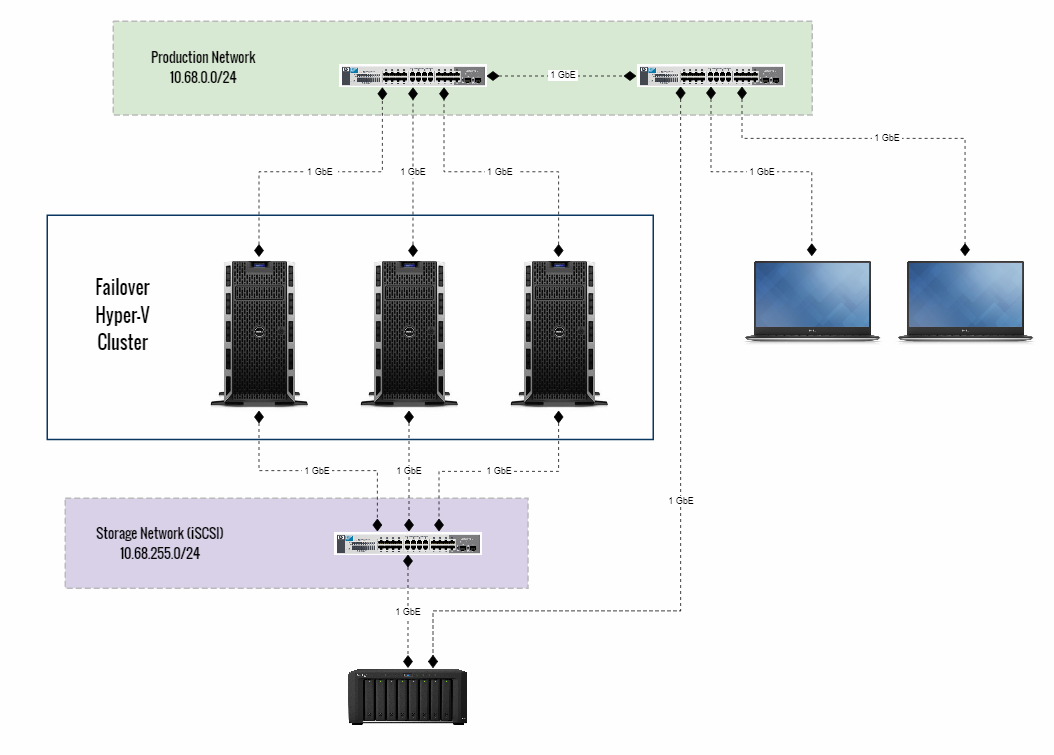

1. The current setup with 1 Synology and 3 Hyper-V nodes
Current setup
Current setup

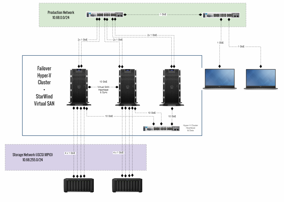

2. The new setup with 2 Synologys and 2 nodes (Virtual SAN + Hyper-V)
New setup (2 nodes)
New setup (2 nodes)

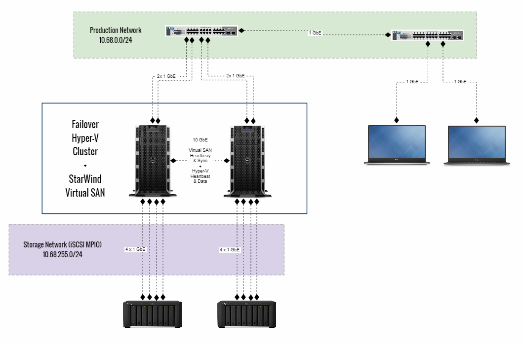

3. The new setup with 2 Synolgoys and 3 nodes (2 Virtual SAN + 3 Hyper-V):
New setup (3 nodes)
New setup (3 nodes)

Mon Oct 16, 2017 3:17 pm
Enric,
Thank you for clear diagrams. This makes it much more easier to understand your intended configuration.
So, let's consider 2-node and 3-node scenario separately.
2 nodes:
Everything is fine except for you will need to buy not a single-port 10 Gbit card, but a dual port 10 Gbit card. The reason for this is that you will need to have a separate link for Synchronization channel (StarWind only) and another one for iSCSI (data read-write operations for clients). Except for this, everything is reasonable there. For Heartbeat, you can use the management network as well.
3 nodes:
The depicted setup is also possible. In this case the cross-connection link should be between node 1 and node 2, as you showed it, and the 3rd node will be connected using a 10 Gbit switch. The same switch-based connection will serve as iSCSI link for all servers, too.
My only concern is the way you are going to manage the Synology boxes, as they have no direct connection to the Production network switches. But if you are fine with managing the boxes from your servers, I would not object.
