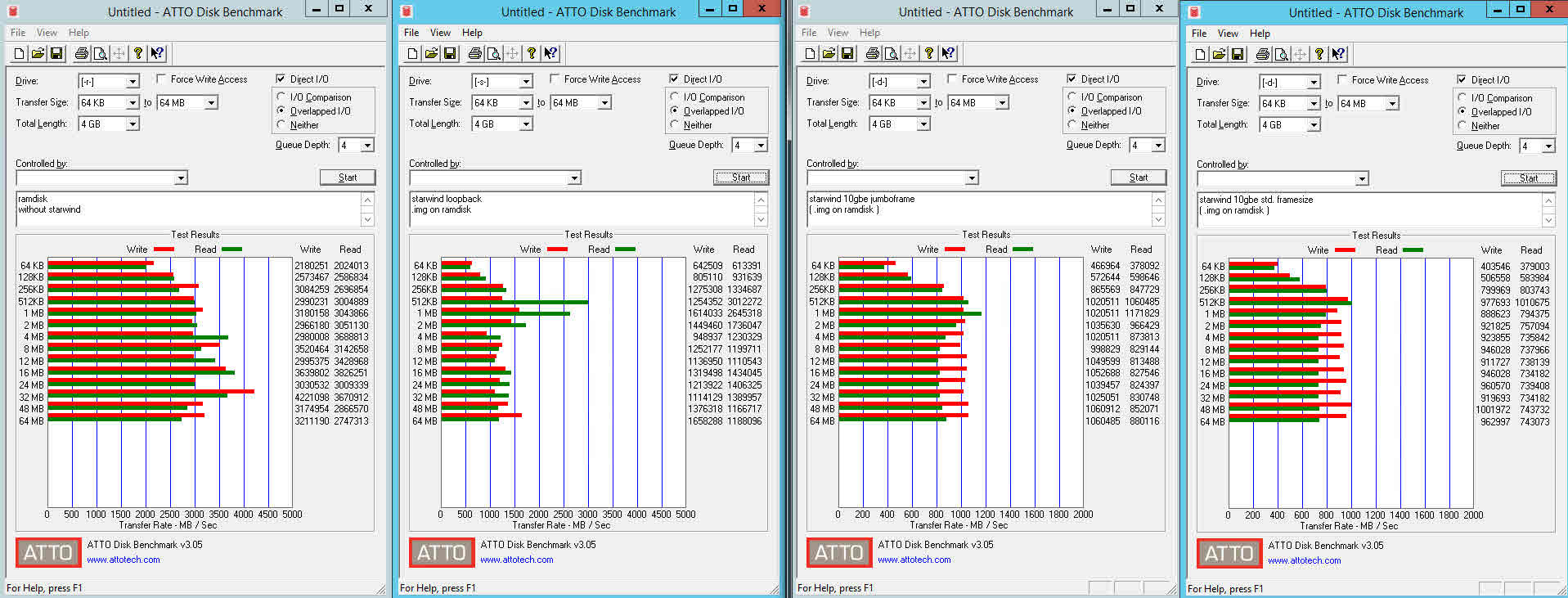

with the new hardware i did some testing to find optimum performance
( OS 2012R2 , Mellanox 10gbe Network )
i found that:
- HDtune is not good for testing ( confusing results )
- ATTO shows better results
after testing with raid , i went to a nvme disk to eliminate the influence of raid settings.
after that i went to RAMdisk based testing.

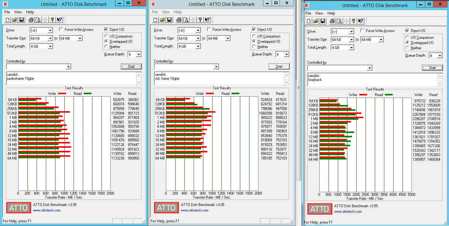

Starwind RAMdisk
Starwind RAMdisk
testing with slower disks showed allmost no difference with Jumboframes
with ramdisk, the Jumboframes showed about 12% better performance, allmost close to full wire speed.
but also std network setting shows a good iscsi performance.
( dont forget to enable also the switch to jumboframe ! )
after that I installed a RAMdisk (with Softperfect RAM Disk 3.4.8.0 free version )
and did further testing
the local RAMdisk in direct access ( without Starwind ) shows a hughe performance of about 3000 MB/s
the Starwind disk ( .img on this really fast RAMdisk ) is showing only 40% of the performance ( in loopback mode )

Great,
2 iscsi connections bring much better performance ( only -20% loss to the direkt hardware access )
on smaler packets the gap is a little bit more.
3 connections or lowest queue setting have small positive effekt, so round robin with 2 connections is fine.
