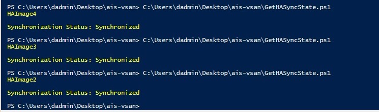

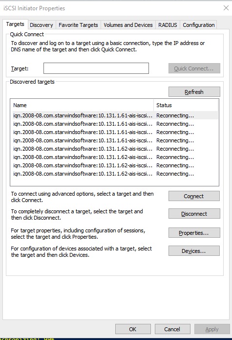

We have been using your software for five years now. Thank You! We stayed on V8 build 11456 (August 08 2017) for a long time, no complaints, everything worked stably, though the synchronization was long. Two days ago, we decided to upgrade to the latest V8 build 13481. The update went smoothly, but problems started a day later. Approximately every 24 hours, the error “Event 10, iScsiPrt. Login request failed. The login response packet is given in the dump data" and "Event 20, iScsiPrt. Connection to the target was lost. The initiator will attempt to retry the connection.". After that, disks from the Windows cluster are disconnected, all virtual machines are in critical state.
Most interestingly, the StarWind service works, I run the powershell script getHAsyncstate - the Synchronization Status: Synchronized state, but in both servers the iscsicpl state is reconnecting. I rebooted the starwind service, also I'm try deleted the targets from iscsicpl and added again - it did not help. Only server reboot works.

The issue looks to me as iSCSI session hang.
There are iSCSI misconfigurations.
1) Witness has partner connection. In hyperconverged setups (i.e., storage and VMs are running in one box), it is recommended to connect witness disk (called Quorum in your setup) only locally.
2) ais-iscsi-slow target is connected from HV-02 to HV-01 but there is no local connection for ais-iscsi-slow on HV-02. On HV-01, there is a local connection, but no partner connection for ais-iscsi-slow. Please make sure that this target has local and partner connection.
If the issue is still there, please consider re-doing iSCSI initiator part once again. Looks like that the issue is there... Make sure to clean favorite target list before adding new targets.

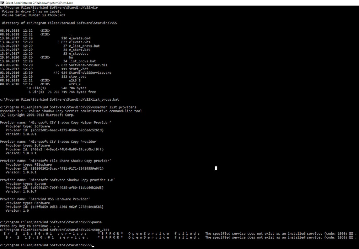

I have also noticed that full installation of StarWind VSAN was performed. Here are the commands to run on each server to remove the unnecessary components.
1. Uninstall StarWind SoftwareVSS Provider
Run as administrator: "C:\Program Files\StarWind Software\StarWind\VSS\stop_.bat"

Delete VSS did not work, it gave an error in the screenshot.

You can remove VSS provider with
cd "C:\Program Files\StarWind Software\StarWind\VSS\"
stop_.bat
Disable StarWind NVMe-oF Target in services. It should be just fine.
