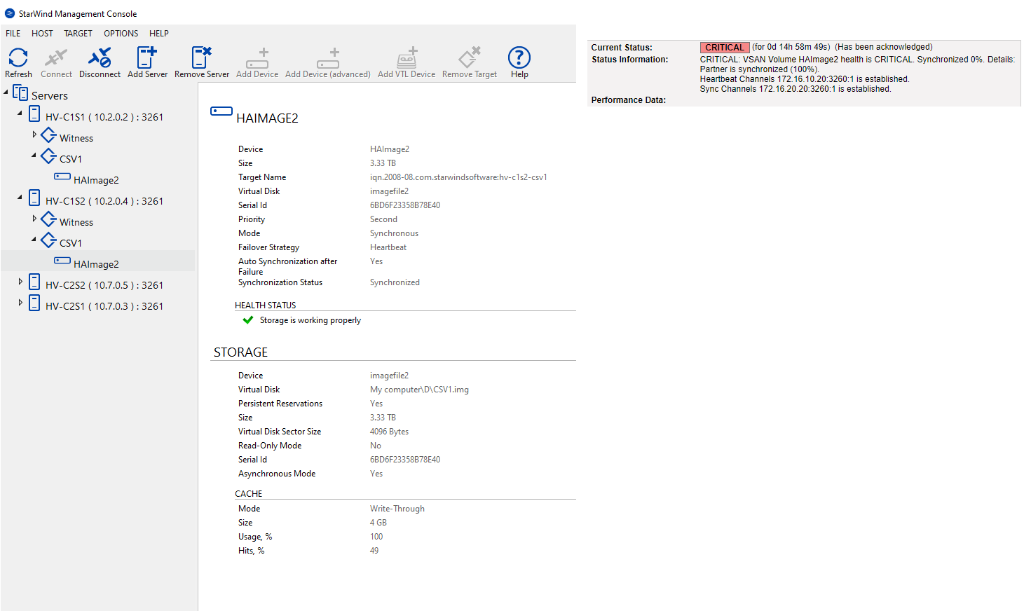

We had a power event and both nodes where graceful shutdown by the UPS. After coming back up StarWind Management Console reports that all HAImages are Synchronized. We use a PHP script Nagios plugin to keep an eye on our Starwind VSAN, the script is reporting that the Partner node is 100% synchronized but the local node is 0% synchronized. We are using Starwind Free so I only have READ access to the Console.
What can i do make sure both nodes are synchronized so that our monitoring script will report correctly?
Screenshots and script attached.

Hello James and welcome to StarWind Forum!
Please note that StarWind Support does not develop the scripts on purpose. I can still advise you how to check the synchronization state by means of StarWindX. Run SyncHaDevice.ps1 from here C:\Program Files\StarWind Software\StarWind\StarWindX\Samples\powershell. The outputs will show you if HA devices are synchronized. Run the script for each HA device.
Let me know if any assistance is required.

SyncHADevice.ps1 and SyncHaDeviceAdvanced.ps1 both report all devices synchronized on both nodes. Any idea why the monitoring script might be reading something different?

If the StarWindX scripts report that they are all synchronized, there is nothing to worry about. Could you tell me when the script is triggered?
Try restarting the StarWind Service on each node. The procedure looks pretty much like one described here https://knowledgebase.starwindsoftware. ... installed/.
If the issue persists, let me know, please.

Moving all VMs and restarting the Starwind VSAN service cleared the error with the monitoring script. Thanks for the help.
