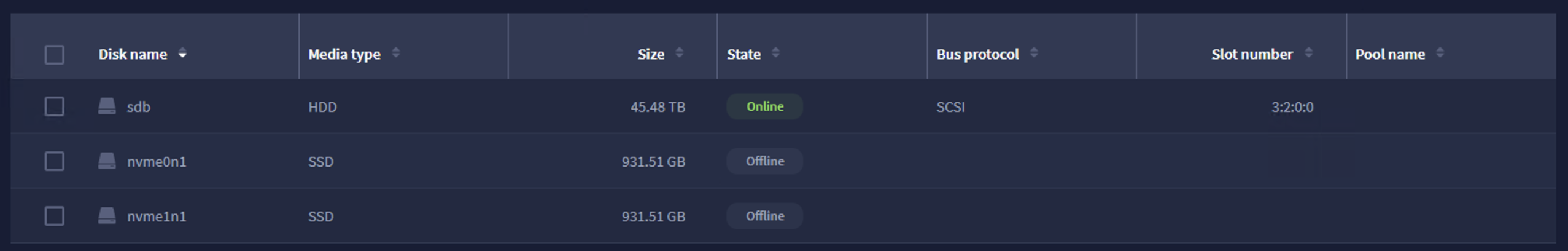

Here's how it appears when I don't create a software raid manually. There's no "bus protocol" or "slot number" for NVMe. Is it normal?
Drives list with NVMe.png (155.77 KiB) Viewed 16830 times

Thank you for your questions. Your query appears to be related to StarWind SAN & NAS not StarWind VSAN.
It can be a GUI problem. Are you able to operate further with the disks?
Also, RAID 0 provides no redundancy. Given that, can you format individual NVME cards as XFS to avoid software RAID overhead?
