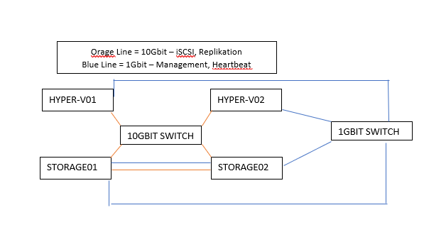

m.witte
Joined: Fri Jul 08, 2022 6:11 am
Mon Jul 11, 2022 8:06 am
Network
Network
Screenshot 2022-07-11 100515.png (11.34 KiB) Viewed 7263 times

Posts: 3599
Wed Jul 13, 2022 12:22 pm
Greetings,
Thank you for the logs and the diagram! I have reviewed the logs but I don't understand what exactly is the problem. StarWind HA devices seem to be in sync and go out of sync only during service restarts. I'd appreciate having the logs from the compute boxes to see if there are any "unexpected" target disconnects.
