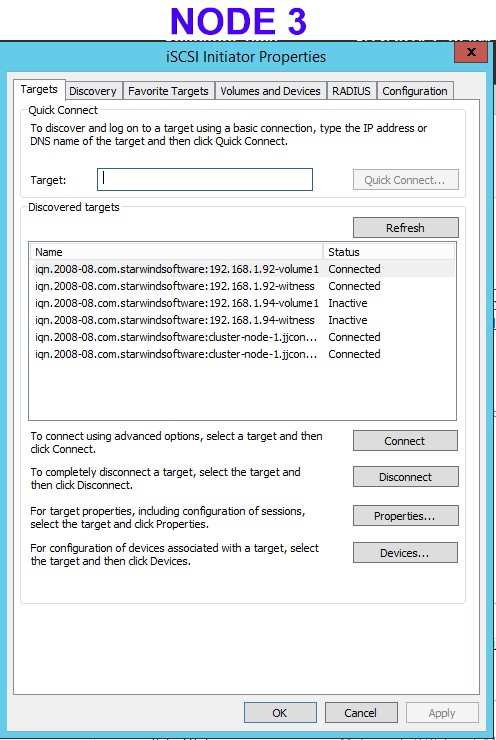

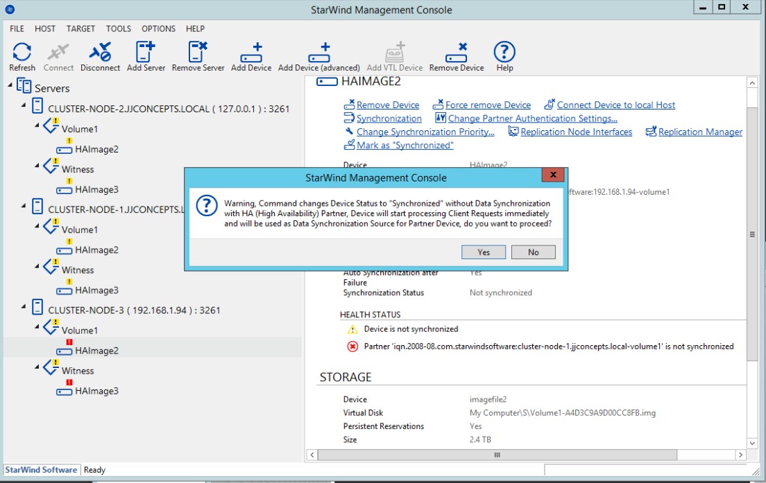

However the difference is that I have a 3 node cluster. After a reboot the node came up with the iSCSI targets for the Witness and the Volume inactive. I tried all of the Microsoft debugging but when I tryto reconnect the target, it says iSCSI service unavailable. I have tried recreating the target and Starwinds KB https://knowledgebase.starwindsoftware. ... kb4019215/ but this did not help either.

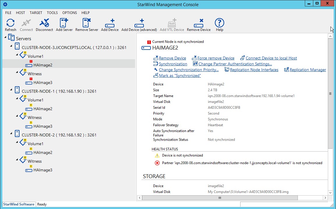

This is the Starwind Console on the Node3
If I follow Ivans' advice in the similar post, he says go to a known node with the "Most recent data" (this would be either Node 1 or Node 2 for me, and open the Starwind console select the unsynchronized node 3 (HAImage2 or the Witness HAImage3) I get this message. This freaks me out as this is a production cluster so I don't know what to do.
This is Node 2 clicking on the Node 3 connection and clicking the "Marked as Synchronized" on either one of the Volumes
Check the favorite targets tab.
Are devices on other nodes not synchronized?
If so, this article might help https://knowledgebase.starwindsoftware. ... -blackout/.
Also, it appears that you have access to GUI. Please contact StarWind Support support@starwind.com

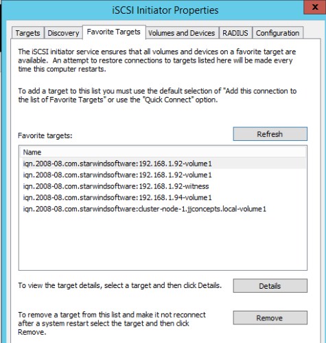

The other nodes are fine Node 1 can connect to itself and 2 and 2 can connect to itself and node 1 Node 3 is having the problem connecting to itself, 1 and 2
Favorites tab attached:
iSCSI Favorites.jpg (68.47 KiB) Viewed 10827 times
I read the article however Node 1 and 2 that are fine do not give the “Mark as Synchronized” option. Only Node 3 however
based on the warning I got I can't risk losing a production cluster (Hence posting here)
Thanks for the assistance

Nodes 1 and 2 are synchronized since they are presenting the storage.
Please restart the StarWindService on the not synchronized node and collect the logs using https://knowledgebase.starwindsoftware. ... collector/.
Also, I can see you have access to GUI. Please contact StarWind support at support@starwind.com use this thread as a reference.

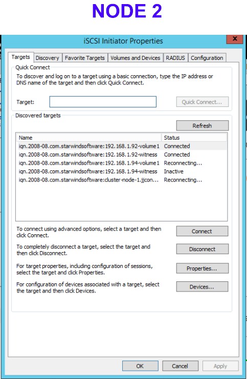

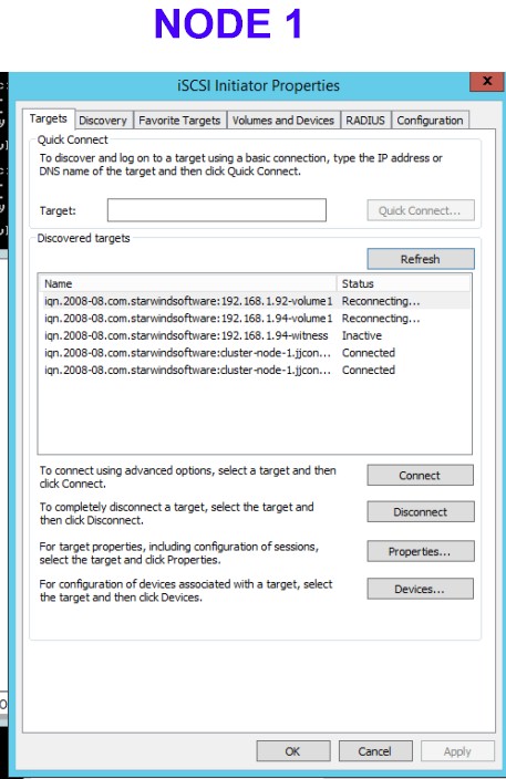

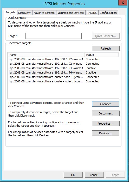

I am wondering now if the problem isn't Node 3 Here are the iSCSI connections on all three
Node 1: cluster_node_1.xxxxx
Node 2: 192.168.1.92
Node 3: 192.168.1.94
Posts: 3598
Fri Jul 22, 2022 2:52 pm
It's not about the iSCSI connection alone. Can I have the logs from 3 nodes, please?
