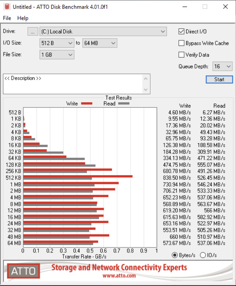

I tried it with CVM and a Windows VM. As soon as I present the StarWind disk via iscsi to the ESX host, I only have around 500MB/s write and 300MB/s write.

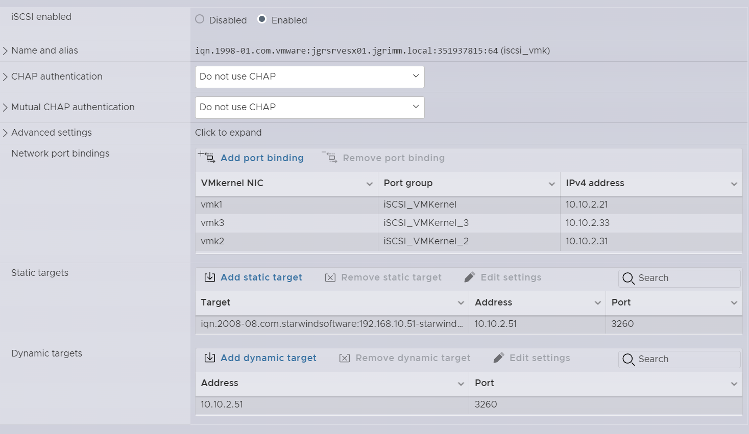

It is. Try using more iSCSI sessions, i.e., try using more VMkernels, and port groups, and discover the targets over iSCSI more IPs therefore. SRIOV here could help too.

I have made 3 vmkernels with different IP addresses, but in the same range. I don't know how ESX splits this up but the performance is unfortunately just as bad as if I only use one VMkernel
I have change Disk.DiskMaxIOSize to 512 and checked the I/O Schedule, all correct and SRIOV is enabled in the BIOS for the Network Card. in ESX i don't find an option.

1 GB file is too small use something bigger. Also, it is important to understand underlying storage performance numbers.
