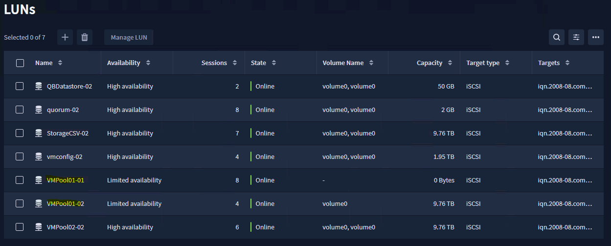

Following some more reboots to complete the maintenance, the LUN has broken again in the same way that it did originally.
Screenshot 2024-09-12 074150.png (44.26 KiB) Viewed 8594 times
Is this a bug?
Posts: 3599
Thu Sep 12, 2024 12:13 pm
Sorry to read that.
Could you please let me know what exactly was done?
You could reach to support@starwind.com using this thread and use 1213496 as your reference.

Thu Sep 12, 2024 12:39 pm
Prior to additional restarts. I validated that all my LUN's were 'Highly Available'. I only restarted Node 1, the same node that caused the original issue. My troubleshooting / work involved multiple restarts however once I was complete with the maintenance, I checked the StarWind SAN dashboard webapp to find the screenshot I pasted in my previous post.
I will reach out to support now.

Sat Sep 14, 2024 12:23 am
Public Update:
We found some discrepancies in the starwinds configuration file. It appeared that there were multiple image file objects for the same file on the disk, the one that was experiencing issues. After clearing all the config for the issue LUN, the following was completed:
- Removed partner target from node 2 that pointed to node 1
- Deleted header files from the CVM configuration files
- Deleted the LUN files from the disk array
Following a reboot of node 1 CVM, I used the AddPartner script I posted above to rebuild the HA LUN. This appeared to be a successful and complete resolution to my issue.
The original cause appears to be previous failures from repairing the LUN that resulted in leftover bad configuration in the StarWind.cfg configuration set.
