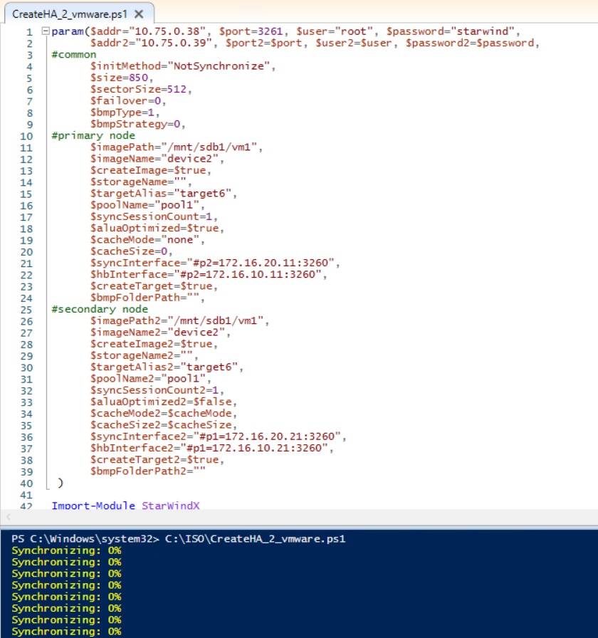

I can create the ISCSI lun but it just says "synchronizing" at 0% forever. I tried it a couple of times thus device2 and target 3 but same issue. VSAN free license. Any ideas where I am going wrong?

Check the MTU and make sure it is set to 1500 on the entire stack. Could you please tell me what hypervisor you have?

Tue Apr 22, 2025 9:40 pm
Using VMware 8.0 update 2. Updated and confirmed that all vmkernels are set to MTU 1500. Rebooted appliances and tried again but same issue.

Posts: 3597
Wed Apr 23, 2025 8:03 am
Try synchronizing them manually. Force synchronization, try using manual synchronization. Use SyncHaDevice.ps1, comment $device.Synchronize([SwHaSyncType]::SW_HA_SYNC_FULL, "") and uncomment #$device.MarkAsSynchronized()
